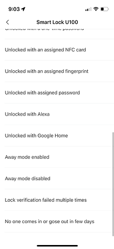

Nothing like that is available in HA over matter, not yet at least. HA isn’t even told when the lock is jammed (the Aqara app knows it but there is no automation trigger unless you use the Alexa skill).
However, you CAN automate on user who unlocked in the Aqara app. With this you could trigger a shared sensor between HA and Aqara to get that into HA.
