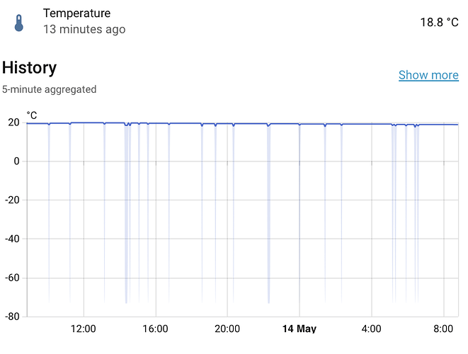

For me the 100k sensors swings ±3C approx.
The 10k that was in the box swings about ±0.5C but I cannot get that into the floor so… ;(
I have created a support ticket to Aqara, this is clearly an issue that several are experiences. Found someone on reddit with the same problem.

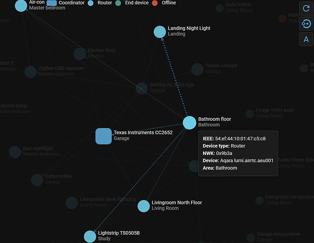

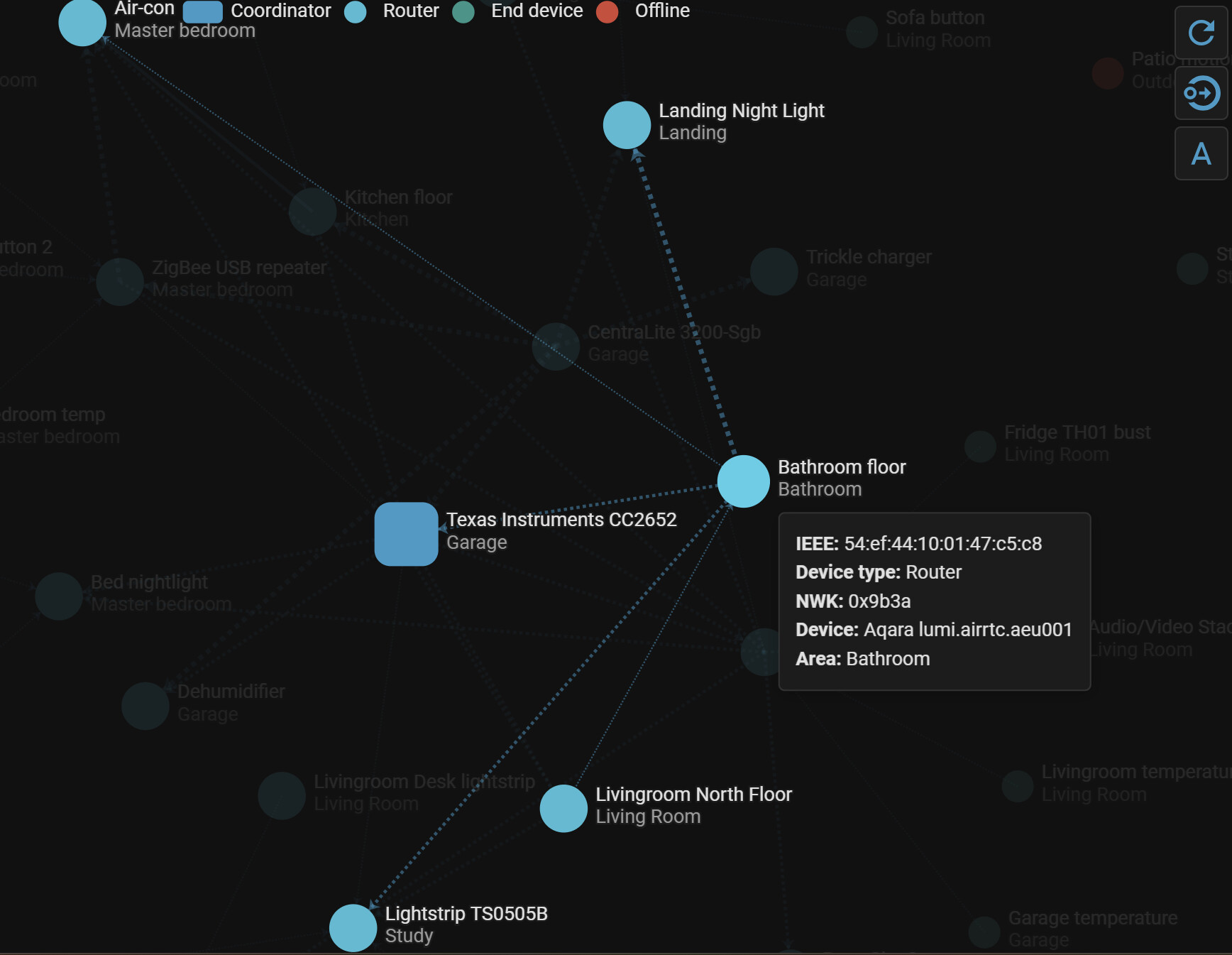

I’m not sure how to measure ‘good’, but they seem to act as routers okay, according to the visulization tool. “Bathroom floor” and “Livingroom floor” are both W500s in the screenshot, and seem to be routing other zigbee devices well enough.
Oh that is great to know. Thank you! I am still using a TS0601 by _TZE284_rlytpmij and they show up as routers but don’t route anything. They look better though :wink:
If W500 are fully ZHA compatible I might consider swapping them out.

Quick info for people who have issue with the floor sensor reading (NTC): this thermostat uses a mapping table of beta = 3950 and supports 10, 50 and 100k Ohm. Previously I was using (most probably) beta = 3435 with 100k Ohm and I was having a temperature varying between ~15.5 and ~20.5 degrees Celsius. After replacing sensor with the one that comes with the device, temperature varies between 19.4 and 19.9 degrees Celsius (±0.3 degree Celsius), which makes sense as resistance changes.
