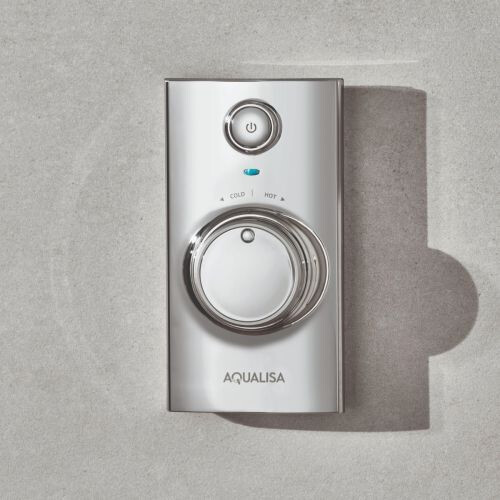

I have a basic controller:
I was hoping that MQTT messages would override the controller, but I setting the temperature or the flow doesn’t seem to work and the request topic gets reset, only the outlet and the time_set values appear to work, which matches the app.
If anyone knows what the flags are used for and if setting different values can override that would be interesting…
