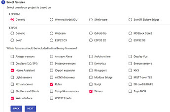

This is what I’ve done:
1 - installed tasmota lite on the esp8266
2-in tasmocompiler used these settings:
3 - in tasmo compiler added those lines under custom parameters:
#ifndef USE_NEOPOOL
#define USE_NEOPOOL                       // Add support for Sugar Valley NeoPool Controller - also known under brands Hidrolife, Aquascenic, Oxilife, Bionet, Hidroniser, UVScenic, Station, Brilix, Bayrol and Hay (+6k flash, +60 mem)
#endif
4- compiled the firmware
5- Upgraded the firmware I’ve created (tasmota.bin.gz) under tasmota firmware upgrade on the device.
6- set the neopool pins NeopoolRx and NeopoolTx under configure module and set it to generic.
7- Configured username, password and address under mqtt.
Am I missing something?
Help would be appreciated.

Maybe try ticking the box for the ‘Modbus Bridge’?
I tried but unfortunately it didn’t work…same results.

ref from somebody else.
right now even with modbus checked in the firmware, I’m not getting anything.
I’m not too familiar with Tasmota and I just want to make sure I’m not doing something wrong in the process.
That screenshot looks to be from NeoPool - I think there are a few more steps to configure that. As seen here: Sugar Valley NeoPool Controller - Tasmota
