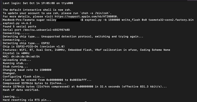

I installed ESPTool on my Macbook, and downloaded the bin-file.
With ESPTool (I think) I flashed the downloaded factory.bin.
The command I used:
esptool.py -b 1500000 write_flash 0x0 tasmota32-core2.factory.bin
This is the result:
Is this a succesful flash?

So the flashing went wrong, or the bin you gave me doesn’t solve my problem.
Schermafbeelding 2023-10-14 om 19.29.28
That bin was flashed by @Cosmin.FRC and it worked fine.
So you have a different issue, recheck cables etc.
Don’t know what else to tell you, sorry. It should work immediately if the cables are ok and you flash correct fw and configure it properly.
