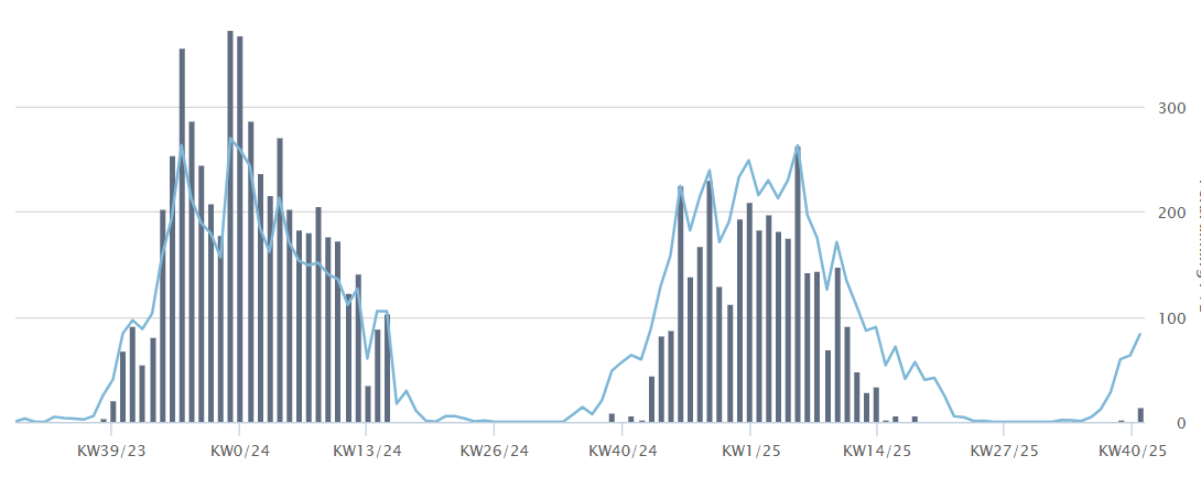

This graph shows our heating in the bar graph and the average of everyone else in the condominium as the line (note that our apartment is about twice as large as the average).
So the winter 2023/2024 we had about the same heating cost as the average apartment, sometimes a bit more most likely due to batteries or not responding while full open. This was a year with TRVs.
The winter 2024/2025 you can see we are below the average (keep in mind the average apartment is a lot smaller than ours).
The result was about $40 less per month.
Looking at the area below the line I would say it seems as our neighbours thought it was a similar winter those two years. Perhaps even colder 24/25?
Now at the end of the graph you can see that our heating demand is a lot less than our neighbours.
I believe this is mostly because we turn off the heating when not home and if the weather forecast says it’s going to be a sunny day then the heating is shut off in advance.
Our room temperature is set to 20-21 degrees c when we are home and nobody can change it.

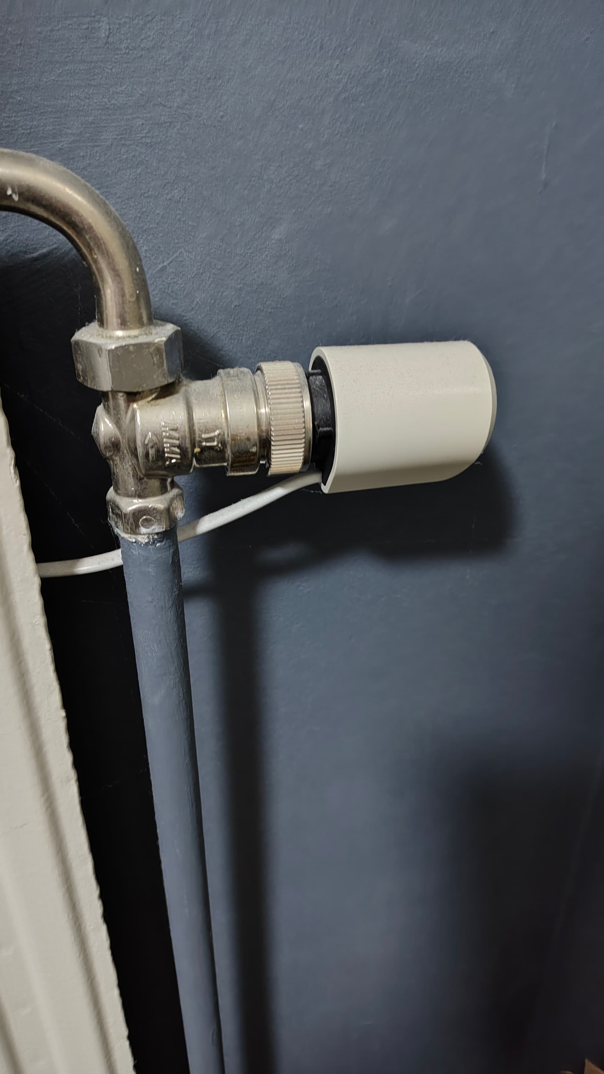

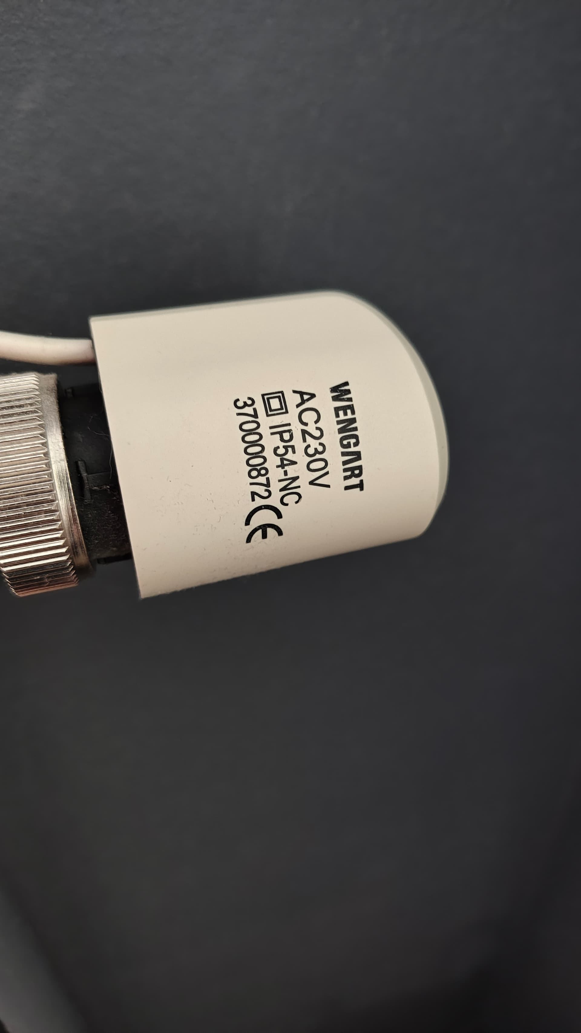

This is an actuator.
It runs on 230 v and has nothing fancy.
The two cables are simply live and neutral, no thermometer, no schedules, no setpoints, no motor.
Pure on/off behavior based on if the switch/relay is on or off.
The movement inside is also different, the TRVs have a motor that spins creating a metal against metal noise. On our radiators this sound/grinding was vibrating the whole radiator making it sound like a cat fight was going on inside the room.
The actuator is plastic and moves straight in or out, no twisting.
This makes them completely silent.
The only sound you hear is the sound of the water rushing in the pipes.
They are however much slower since they work by heating up a fluid of some kind inside before opening.
So 5-6 minutes before the radiator actually opens is not unusual.

And lastly they are CE marked. Although that is not any guarantee

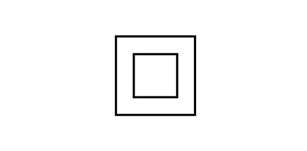

True, if device is double-isolated then it doesn’t have to be, correct. This “double-isolation” is marked on the device with dual square:
The similarities are striking.
Obviously!
Well, if we think as electricians it’s only logical: i assume that this valve contains an electric motor with stator winding, poured into a resin (which makes it insulated), while rotator is only a magnet, which doesn’t have any contact with winding. That makes it double-insulated. Additionally shaft which pushes valve’s rod can be also insulated, which would make whole thing even triple-insulated … :rofl:
