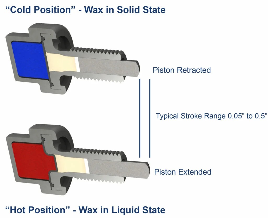

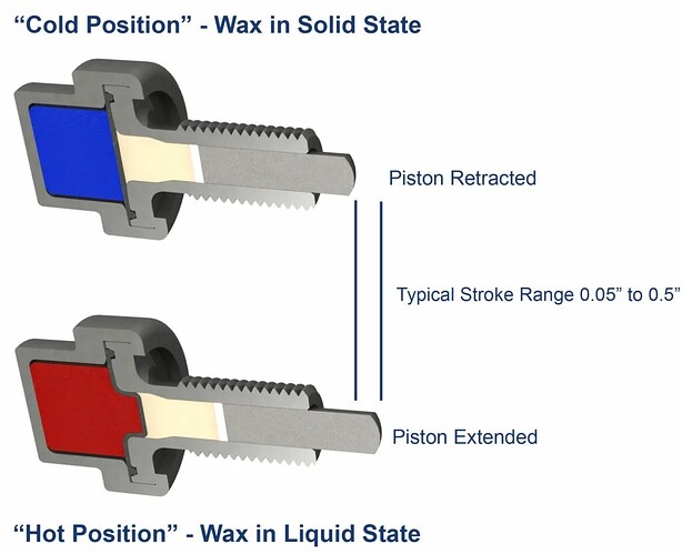

They don’t have a motor, only a heating element.
So they heat up a wax and it pushes the piston.
Or in reverse if NC version as I have.
