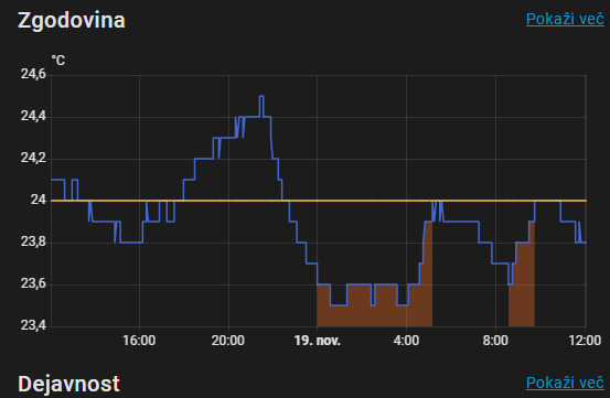

Yeah, me too, but the problem is that not all rooms are equal - or should i say not all radiators in rooms are 100% precisely calculated and installed. Then some rooms have two outside walls + ceiling, some have only one (house is not isolated). As a result i’ve had different temperatures in my rooms before trv’s: I’ve had to regulate water temperature to the point that lowest temperature is at least appr. 20 degrees. As a result i’ve had as much as 25 in some rooms… So i installed trv’s in those rooms and difference is huge. See pic how often valve is closed now (orange is open):

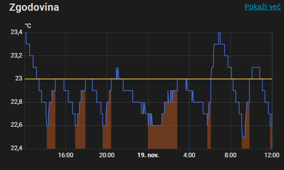

it’s even better in my kitchen and living room:
(yeah, i like it warm…:slight_smile: )
