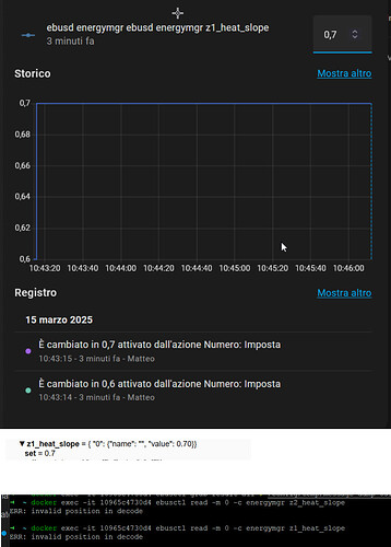

I need help with some of energymgr related messages, looks like ebusd can’t decode them or keeps throwing errors of “invalid position”
f.e, z1_heat_offset, sensys request → got value 0.0:

request → got value -5.0:

Using csv’s from latest repo from git
r1,energymgr,z1_heat_offset,Z1 Heat Thermoreg Offset,,18,2000,6471,,s,IGN:1,,,,,,SCH,10
w,energymgr,z1_heat_offset,Z1 Heat Thermoreg Offset,,fe,2020,6471,,s,SIN,10
b,energymgr,z1_heat_offset,Z1 Heating Offset,,fe,200f,6471,,,SIN,10,°C
err:

How can I check to get/modify this value on homeassistant?
Thanks,
Matteo
Hi Matteo,
it seems that ebusd ran for a little time (a little more than an hour and half) let it run for more time, ideally a sinlge day ad then repost the dump.
Since I started this project, 2 years ago, it seems that Ariston modified it’s ebus use quite a lot. From your dump, simply it seems that the z1_heat_slope parameter is never transmitted, 6a71 command id never appears in your dump
Try to read it explicitly with
ebusctl read -m 0 -c energymgr z1_heat_slope
Also try to open the various branch of the tech menu while ebusd is running to force the system to read those parameters, this should give us a glimpse of what kind of queries the system use then post another dump.
I tried to set the value of z1_heat_slope from mqtt entity
and the value was writed correctly on ebusd becasue I see it.
But if I try to change it from control panel I saw this log on ebusd
I tried also your command, but doesn’t work:
I confirm that the z2_heat_slope working correctly on read and write command, but on ssh terminal the result it’s the same of the z1 parm.

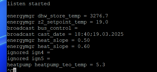

I reattach the new dump

70fe2020046a716400 = 18: energymgr heat_slope

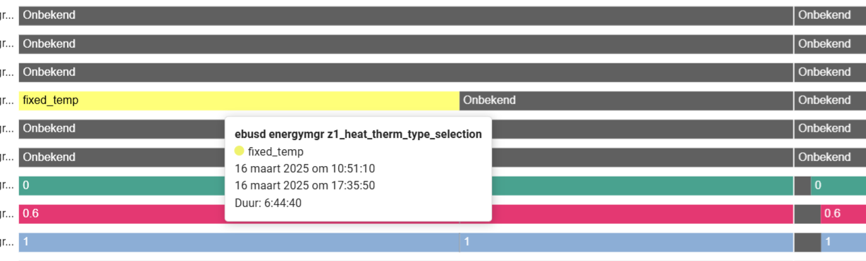

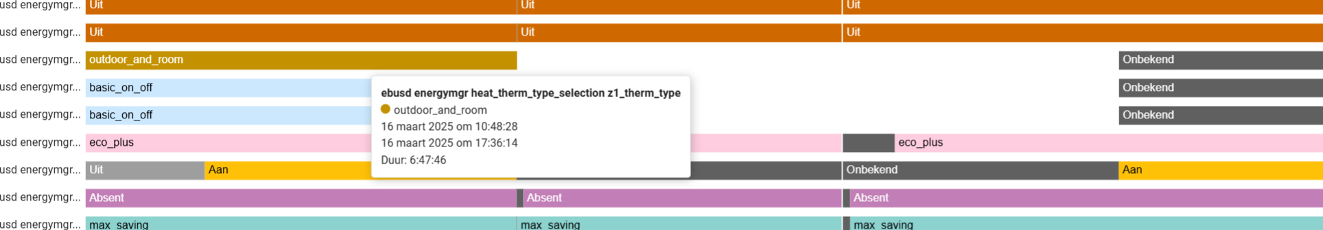

Same here. Z2 does communicate more values than Z1 and Z3. Very strange indeed. I suspect that setting the values ​​on the Ariston equipment wakes up the ebus for that value. I am now playing with zones and suddenly see all kinds of new values ​​appear in previously empty fields like the ones you mentioned and the zones therm_type_selection.
I did fill out some parameters on the Ariston Energy Manager via their display. For example the slope for the zones and the way of heating (radiator, underfloor) After that, new values poped up in HA.
So after change the value on the display, do you see the slope value of Zone 1 in HA?
Jeah…sometimes. Here is an example:
or:
I don not know why some values appear and disappear later. I suspect working on the Ariston display triggers something.
The likely explanation is that when you do the reading via the remote control interface (sensys do Ariston brand) ebusd is able to detect those readings and these appears on HA. After a while another message pop up or ebusd tries to read but the value is invalid/not decoded properly and the value is set to unknown in HA.
At least this is my interpretation.

for example into my dump i found this value (z1_heat_slope, after clikc on display control):
13fe20 0e 08 6a71 3200 1400 6400 and I found also my value that i Set into display control 3200-> 0.5 , so if I understand how to convert this value to a row of csv file i can create a complete csv and after that publish it in this topic.
Thanks
Another things, with the listener command i see the slope value correctly:
I have tried editing the csv file many times but if I change even 1 character in the csv file nothing works anymore XD .
