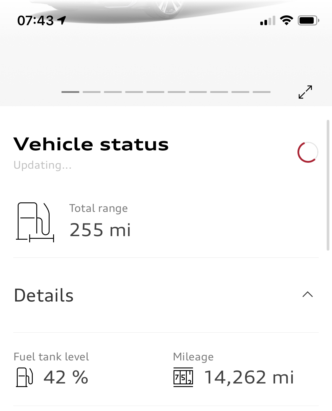

Strange, you bought your car in the UK and the output from you mileage sensor is in km?
Only my HA integration.
The car is a UK model, the app and website show miles but the integration in to HA shows it all in KM.

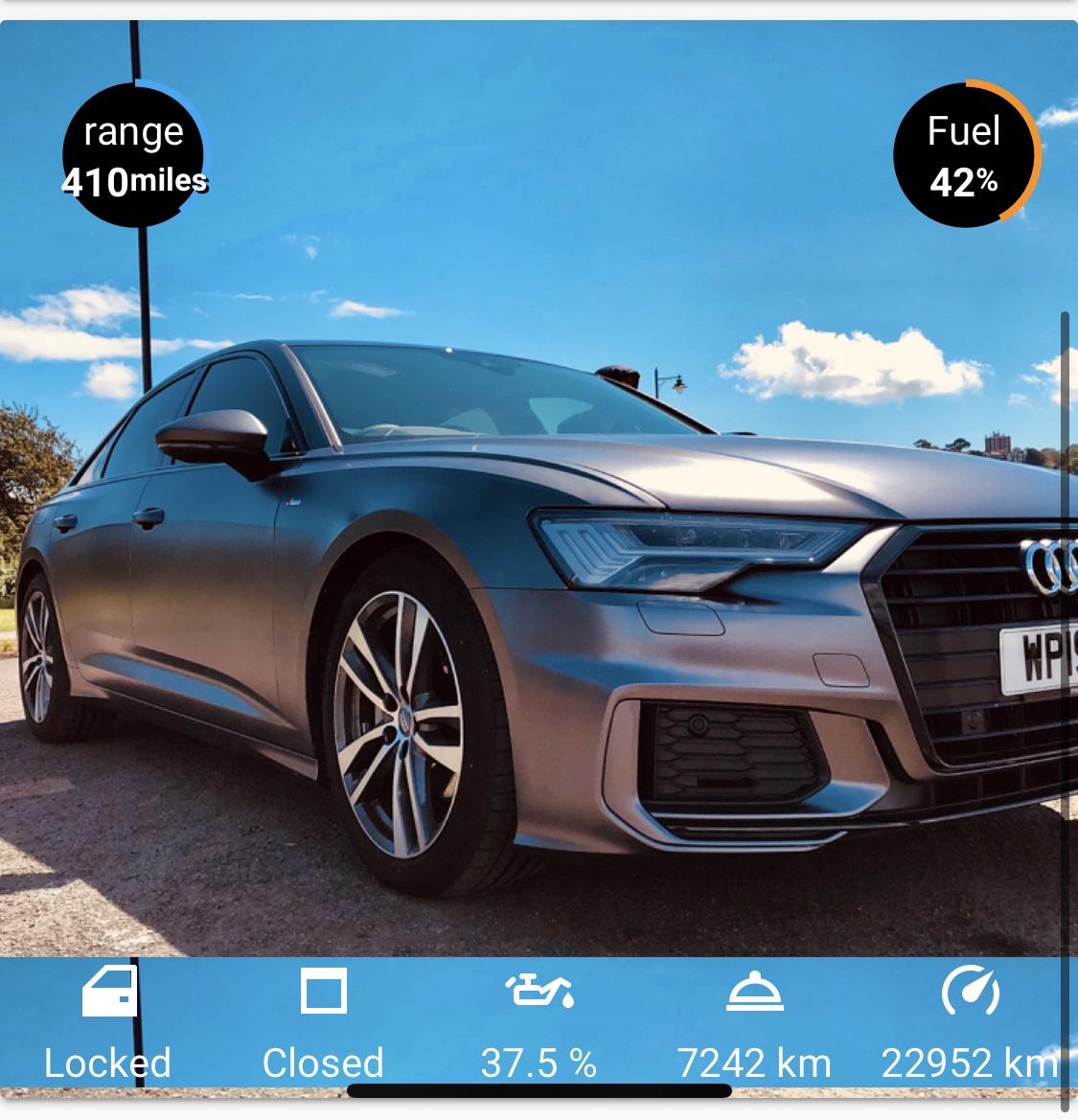

Card needs a bit of formatting work but you can see that all the figures are in KM. - Range shows ‘miles’ where I changed the text previously but the figure is a KM reading.

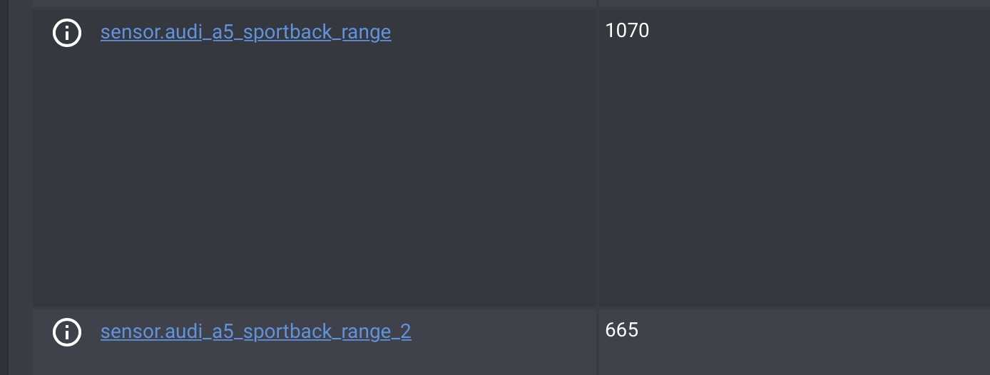

check your sensor .range and .mileage in the developer tools.
What state you have there for the 2 sensors?
Both range and milage sensors show a km reading.
Easiest solution short of modifying the integration would be to make a template sensor which does the conversion behind the scenes. You will need to do this for every value you want to have converted.
I still don’t understand why you get km instead of miles, maybe something went wrong with the integration…Maybe a reinstall could solve it or use this for converting km to miles in your config
  sensors:
    audi_a5_sportback_range:
      unit_of_measurement: mi
      friendly_name: "A5 miles"
      icon_template: mdi:speedometer
      value_template: >
        {{ (states('sensor.audi_a5_sportback_range')|float/1.60934)|round(0) }}
I just tested this in my config with success :
1070km = 665 miles
