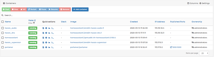

Hello, I have problem with audio on my PC with Ubuntu after I installed Hassio in Docker. I found out that the hassio_supervisor container automaticily create another container called hassio_audio and this container is the problem. If I stop this container the audio start works normally, but after a while, the hassio_supervisor automaticily start the audio container again and the audio stop working.
I don’t need audio in Home Assistant, so how I can disable the hassio_audio container permanently?

OMG, this is the problem? I keep trying to run mpg123 from the command line and it’s getting hung up. I reinstalled pulse audio and it would show it decoding but no audio. Going to try stopping the audio container to see if that fixes my issue…
just stopped that container… yep, that was my problem. Audio is working again.

OPHoperHPO has created a Hass.io add-on that fixes the problem (it executes the pactl load-module module-suspend-on-idle command) every time the container is restarted. You can use the following repository in order to install the add-on: https://github.com/OPHoperHPO/hassio-addons. Works great.
