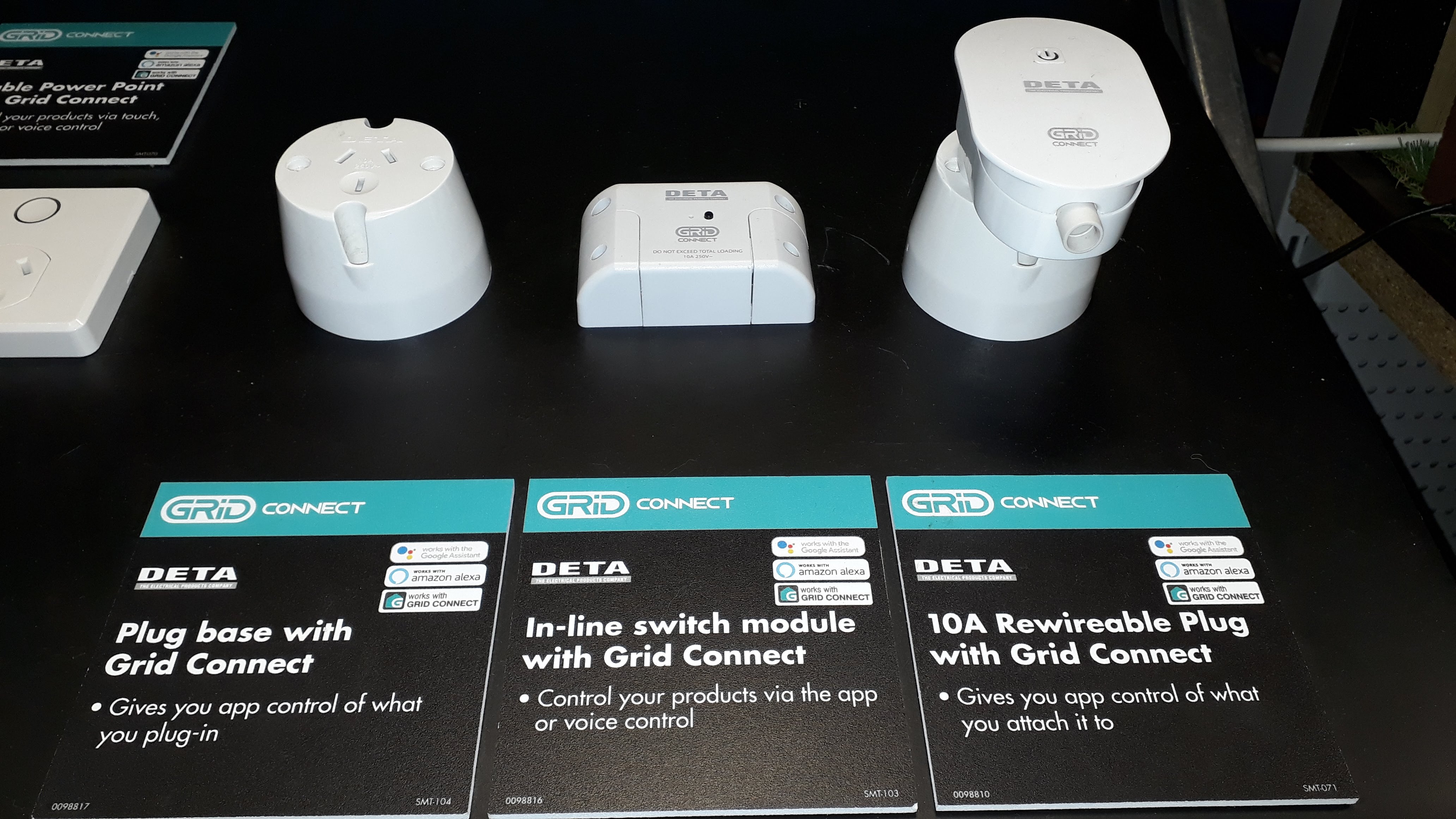

Boxing day at Bunnings, to pick up my bit to show the architect. They had a whole display on smart home devices, including a few things not in the web site yet:
A “plug base” and sonoff style inline relay. The rewirebale plug, I knew about and had one ordered, but with the plug base, they should not be necessary.
I found the plugbase for sell $20. The same as the rewireable plug. I purchased a couple.

I relay, one barely visible led inside the hole off to the side of the ground pin, and a next to useless push button inside that hole (it came it a plastic key/pin to press this button for pairing mode).

This device would be idea if it also had a switch terminal on the back, so the sparky can added more light to the same control.

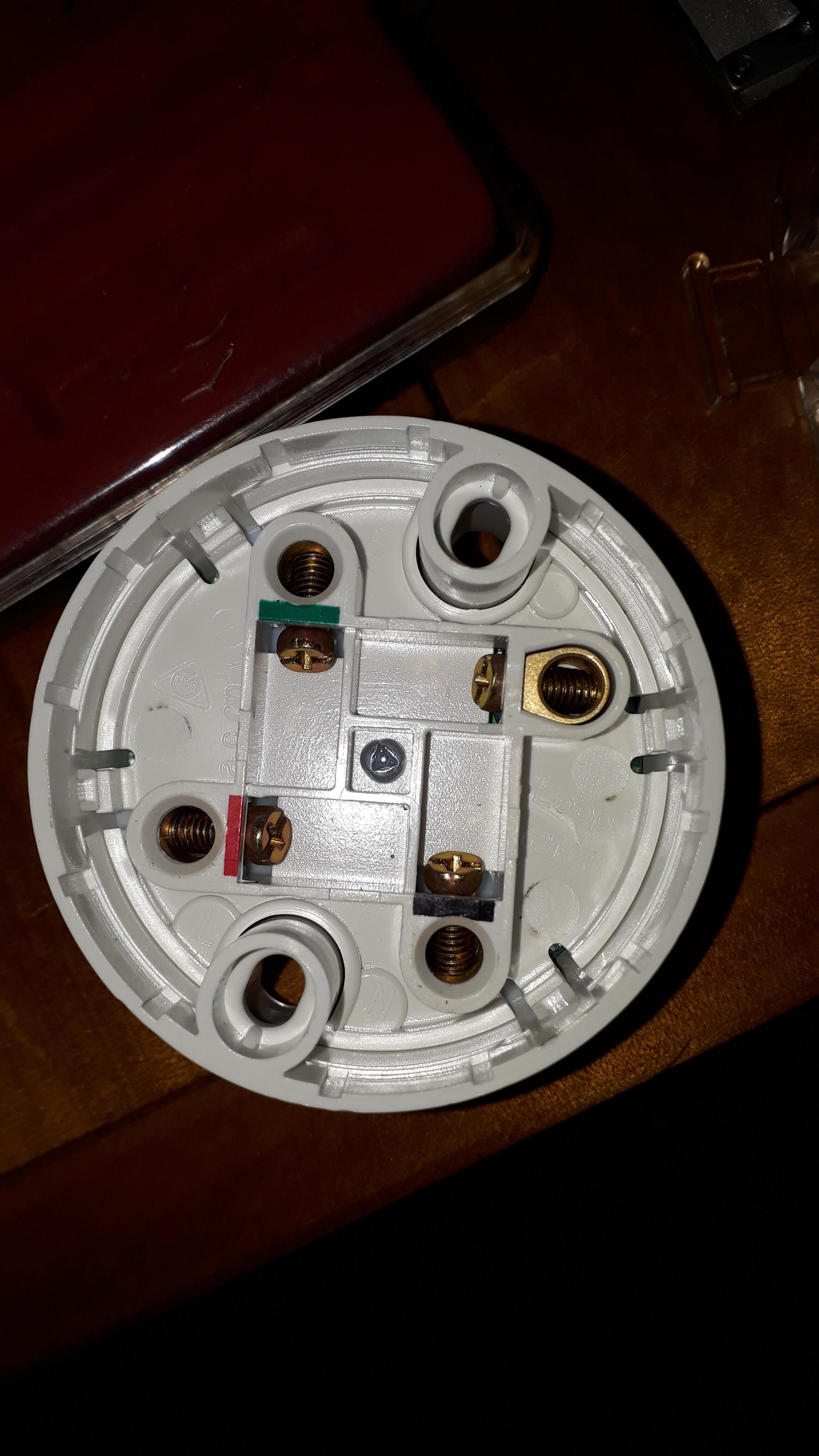

I haven’t not open it up yet. No problem removing the triangle screw, but it requires four tight fitting plastic latches to plied. Through I doubt there is much that be hacked here.
I could not find the ‘sonoff’ reply, or some downlights they had on the display. I was told, the display was only just installed, and they don’t have stock.
