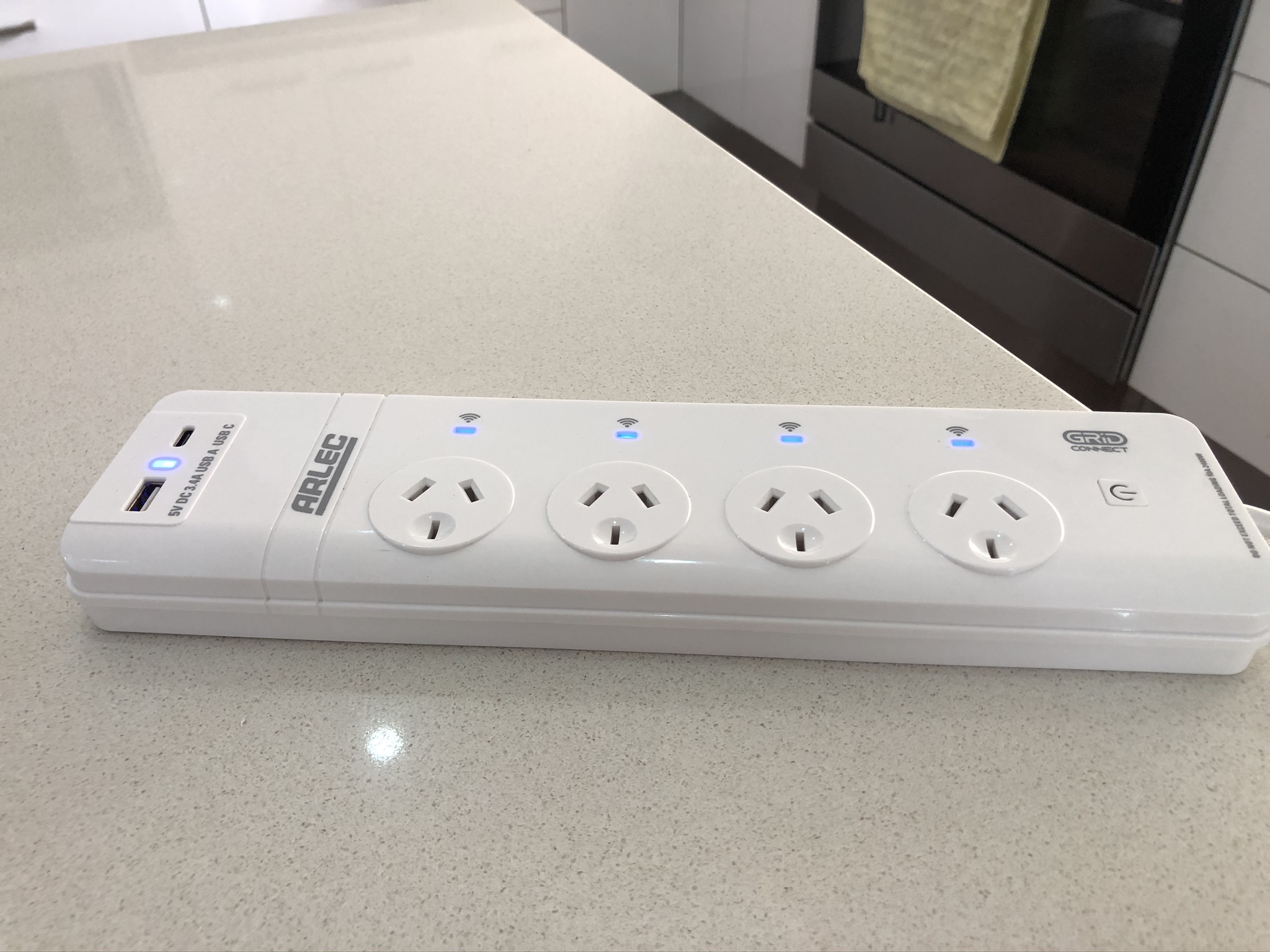

Don’t know if anyone has posted about these yet…
From the GridConnect range at Bunnings.
Flashed it easily with tuya-convert, and made an ESPHome config for it…
esphome:
  platform: ESP8266
  board: esp01_1m
<<: !include .common_config.yaml
logger:
status_led:
  pin:
    number: 1
    inverted: true
binary_sensor:
  - platform: gpio
    pin:
      number: 3
      inverted: true
    internal: true
    on_press:
      then:
        - switch.toggle:
switch:
  - platform: gpio
    name: 'Power Board Socket 1'
    pin: 5
  - platform: gpio
    name: 'Power Board Socket 2'
    pin: 4
  - platform: gpio
    name: 'Power Board Socket 3'
    pin: 13
  - platform: gpio
    name: 'Power Board Socket 4'
    pin: 12
  - platform: template
    optimistic: true
    internal: true
    turn_on_action:
      - switch.turn_on: switch_1
      - switch.turn_on: switch_2
      - switch.turn_on: switch_3
      - switch.turn_on: switch_4
    turn_off_action:
      - switch.turn_off: switch_1
      - switch.turn_off: switch_2
      - switch.turn_off: switch_3
      - switch.turn_off: switch_4
Seems to be working very well!

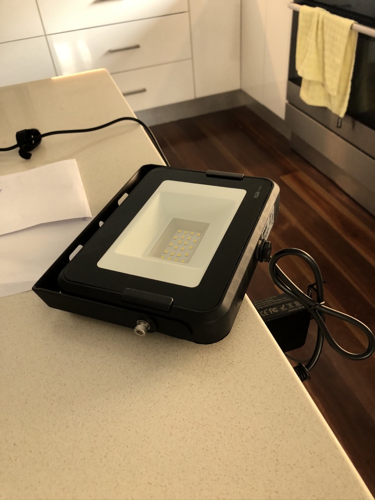

Also the dimmable security light from Arlec/Gridconnect at Bunnings…
Similarly no issues flashing with tuya-convert, and here is the ESPHome config for that one…
esphome:
  platform: ESP8266
  board: esp01_1m
logger:
light:
  - platform: monochromatic
    output: output_1
output:
  - platform: esp8266_pwm
    pin: 14
