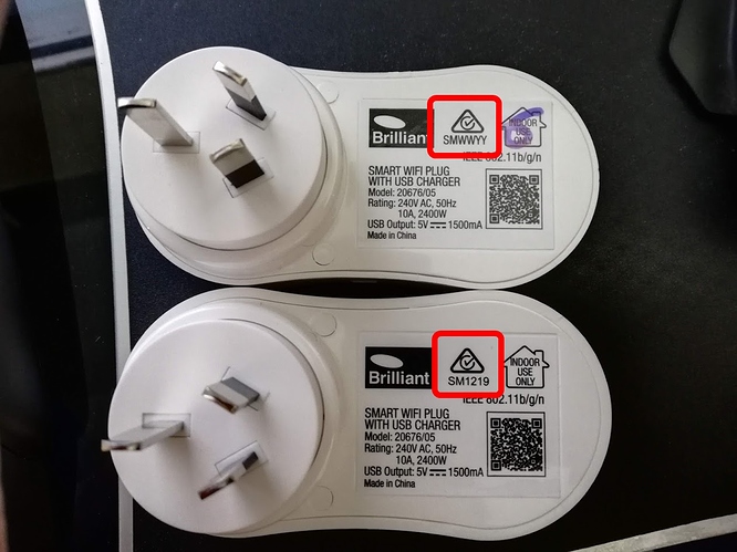

Ordered and had delivered from Officeworks 4 Brilliant plugs and got my first batch that won’t flash with tuya-convert.
The only difference I can see in the packaging and the switch itself is this. The top switch flashed (batch from Bunnings) Bottom one marked with SM1219, from Officeworks, will not.

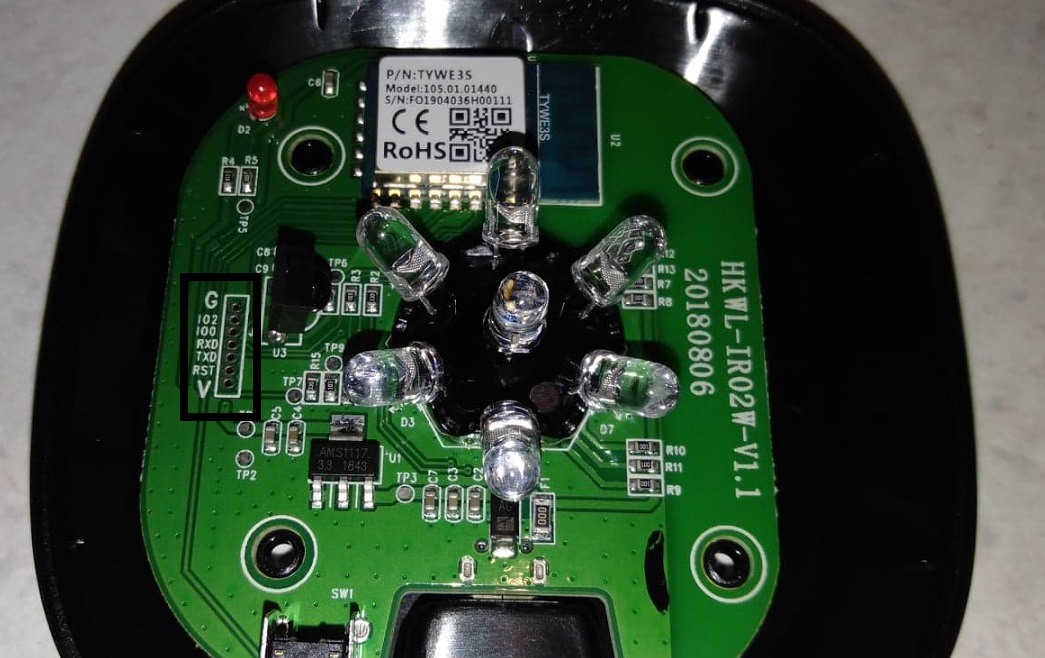

Just finished up flashing with ESPHome one of the Mirabella Genio IR controller from Kmart.
These can be used as alternatives to the Broadlink mini/rm or additional IR commanders.
https://www.kmart.com.au/product/mirabella-genio-wi-fi-smart-ir-universal-remote-controller/2622812
They can be flashed using tuya-convert or by directly attaching to the required header pins inside (requires triangle security screwdriver to open).
Shoutout to @ Radebe2k for initial Tasmota config.
ESPhome config if any interested
