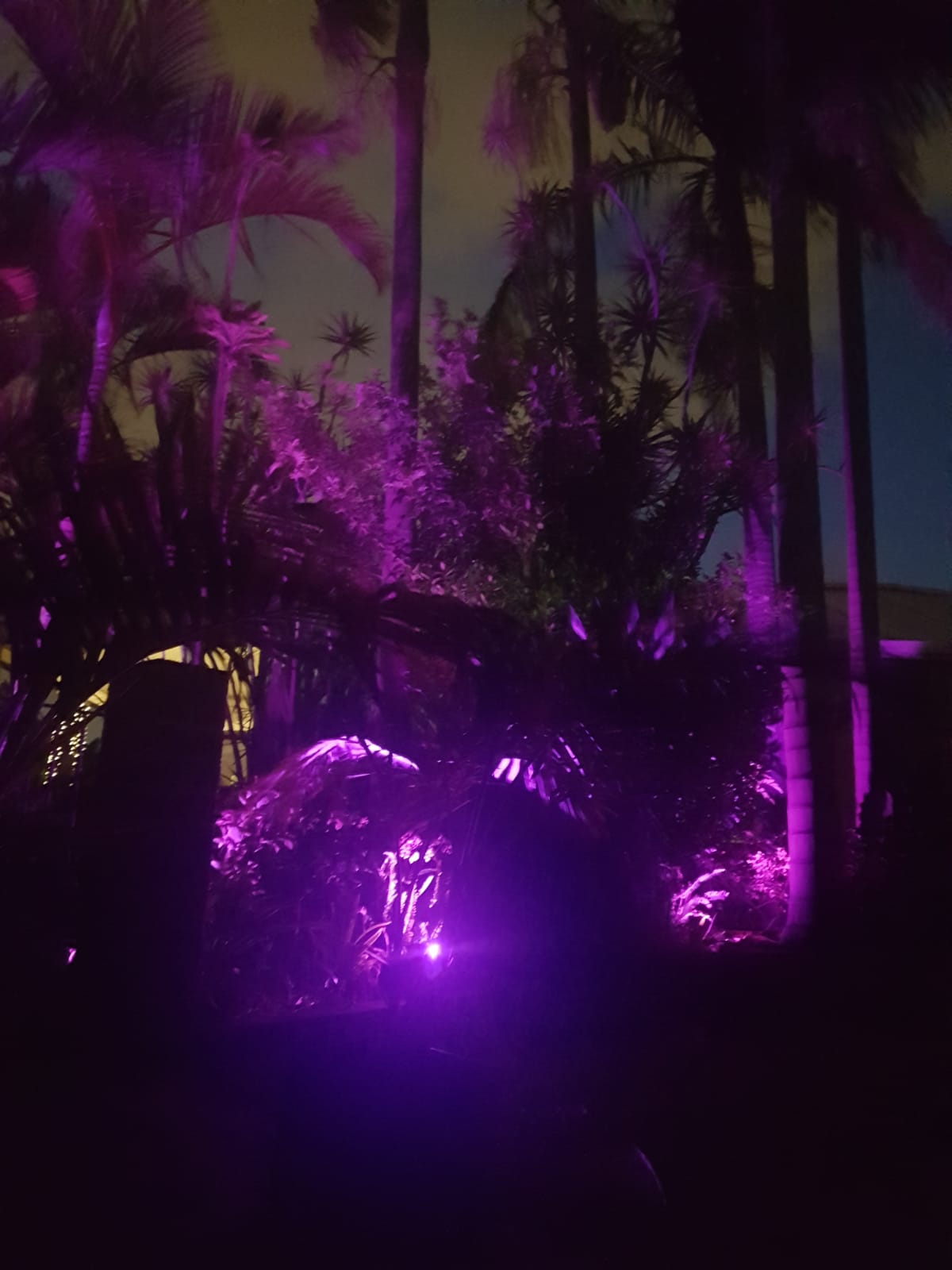

@sparkydave How did the garden lights turn out? Any pics?
Stupidly I didn’t take any photos. I’ll try and get some and post here. They send out a decent amount of light for only 3 Watts per fitting. I would get more if the 40% discount at JD Lighting was still valid (it’s not) but I can’t justify paying full price for them (~$215). I do actually really want more of these so will be on the lookout for them being on sale again.
EDIT: photos… Not the best as the light positions are only temporary, a quick setup to test them out.
Duuuuuuuuuuuuddeee…Niiiiiiiiiiiiiiiiiiiiiiiiiiiiice
Also, I think I saw a single pack them in my local Aldi for $80 last week. They look the same, if not identical. If they have them still, would you like me to grab them for you?
I’ve seen single add-on globes for just under $40 on eBay. I’ll have another hunt around today but I’m in no rush. Thanks anyway
