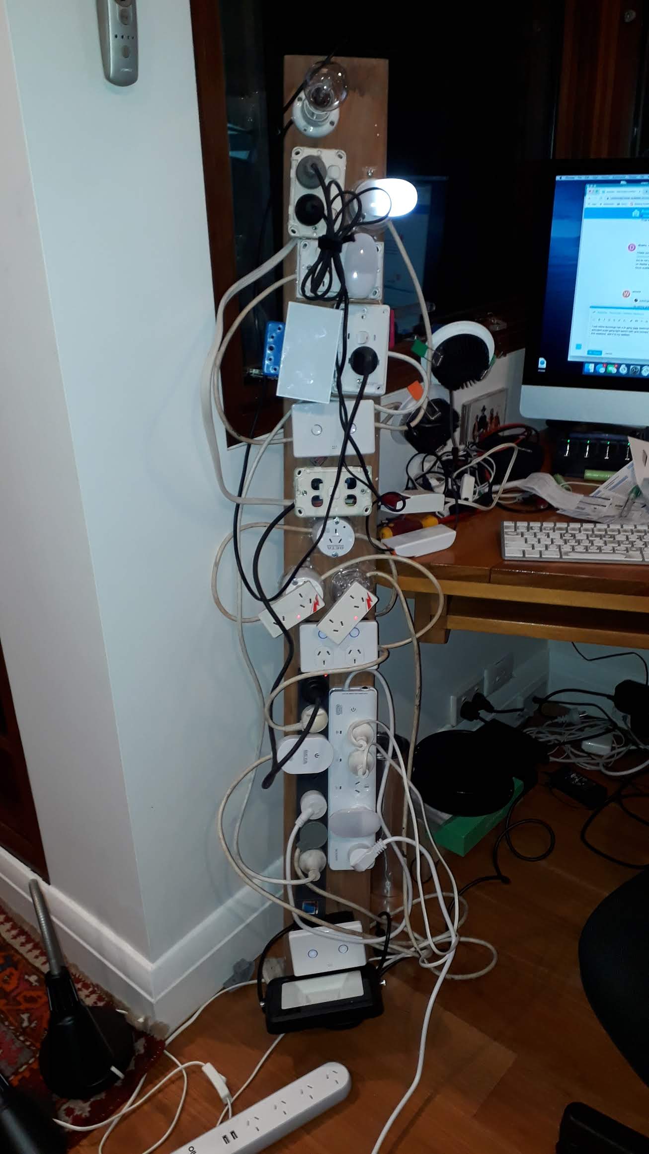

I just notice Bunnings has a 4 gang Deta Switch and a 3 gang. By special order only. I might order one this weekend, add it to my testbed:
We’re doing a renos in a few months, and I’m showing the architect what can be done.
I’ve have a mixture of deta switches,gpos,plug base and brilliant switches, dimmer on tasmota & esphome.
