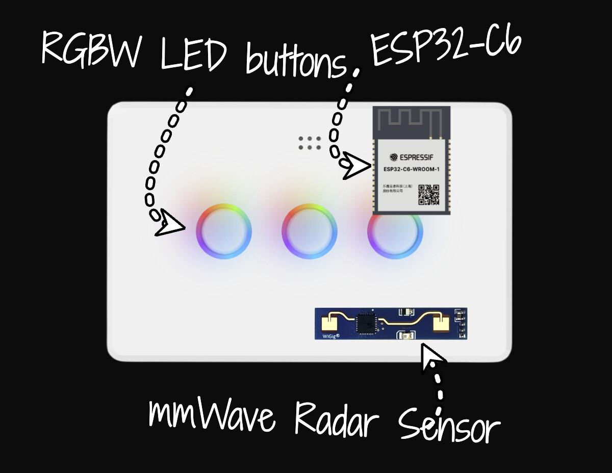

Hey all, I just posted an update on this project over on SwitchRoo: Australia's first ACMA-certified smart switch for Home Assistant with Matter/Thread support
Spoiler: I made it into a real product!
