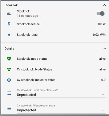

et voilá:
advantage over the config-template-card: it auto-updates immediately (albeit in all the buttons for any change, so it might even be a bit much…
lesson learned: if you need a button in an auto-entities template, create a dedicated template with the full button-config to make life easier ![]()
