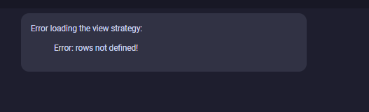

Regarding the grid-view-strategy you did not configure anything so it wonât work.
An empty configuration should display something like this:
The configuration options are specified here

I think you are mixing up area-dashboard-strategy and grid-view-strategy
They are two different things. grid-view-strategy can also only be used in an already existing dashboard like the one area-strategy creates (here with extraViews key) or a simple manually configured dashboard (here with views key; see Views - Home Assistant)
Okay, just to confirm, I would still need to add the configuration for the rows and card type under the grid-view strategy that I have specified under extraViews.
Yes grid-view-strategy always needs configuration ![]()
