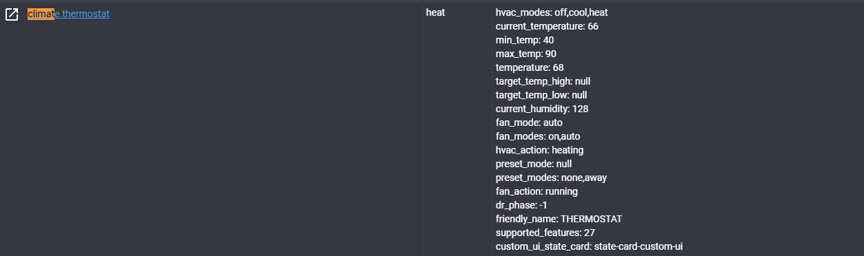

Looking in the developer tools states menu, what are the attributes of your climate integration (far right column)?
tom_l
4
Do you see the problem?
There is no hvac_mode attribute. It is now hvac_action. Also note that the state has changed to heating.
This was changed in one of the recent releases and is an example of why you should read the breaking changes in the release notes closely.
