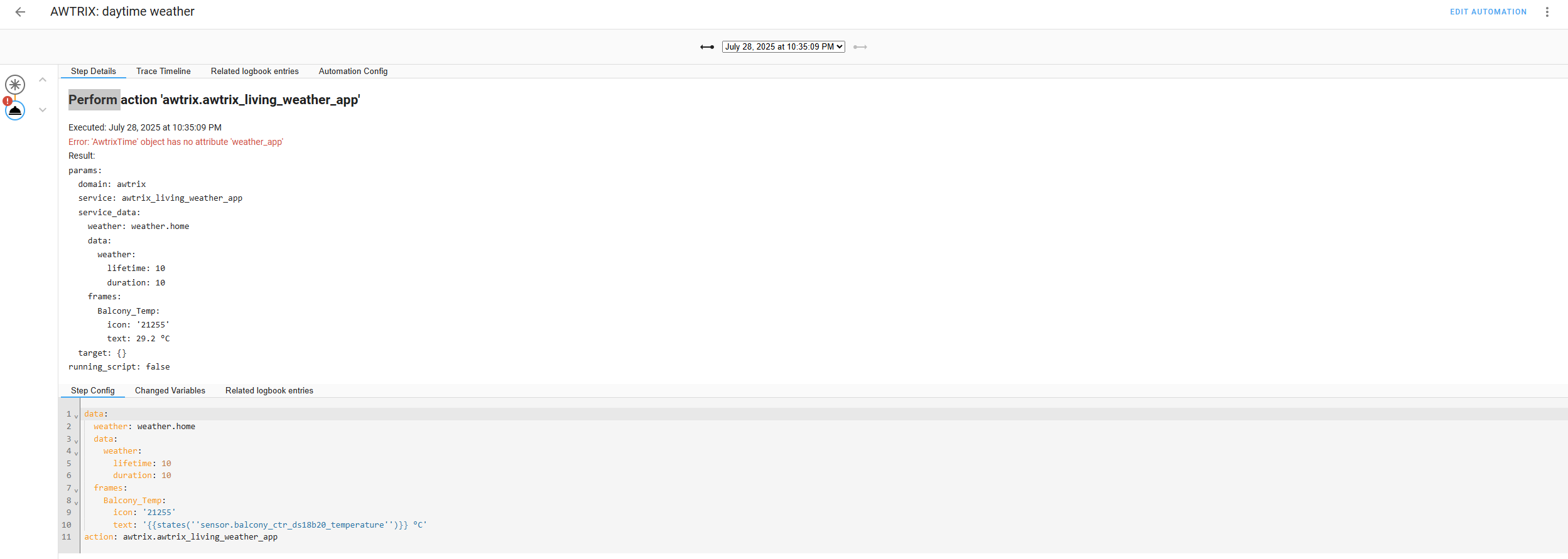

When running action I have this error in UI:
In log I see this error:
Source: components/automation/__init__.py:717
integration: Automation (documentation, issues)
First occurred: July 4, 2025 at 10:25:00 PM (6919 occurrences)

AttributeError: 'AwtrixTime' object has no attribute 'weather_app'
I’ve tried to read few recent posts, I see there is new integration - GitHub - 10der/new-awtrix3-hass-integration: new awtrix3 hass integration (without mqtt)
I’ve also saw a lot of refers to the blueprint you share with us.
I’m a bit confused, not sure how to procced and fix the weather app I had ?
Thanks, Eddi

ahhh got it.
sorry, you are right. Weather app now not supported.
just install a blueprint.
