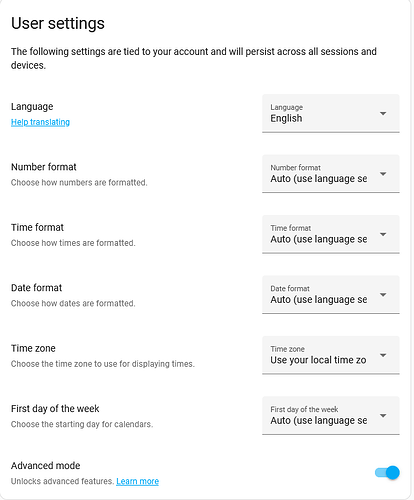

Are you using the vanilla theme ? You can click on your avatar on bottom left of your home assistant GUI et check what theme you’re using.
My guess is that the background img might be setted by your theme and not your dashboard.
You are using the Home Assistant theme.
What happens if you set it to ‘Use default theme’?

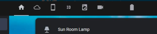

Hello
If I change the theme, then the cards change in the Overview Dashboard, however the background image remains the same - one of a jelly fish. I’ve included a screen shot.

But ALL the views from the Overview dashboard?
Sorry - I didn’t understand the question. No… only the home tab has the jelly fish background; there rest don’t.
Hope this helps.
If you edit that view you can set a background picture.
