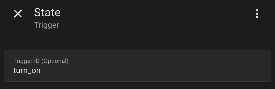

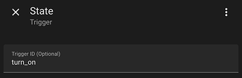

One of the nice things of the new automation editor is it now always shows the Trigger ID field:
Then you can use a choose condition and test the trigger_id.
All this just takes a little bit of practice. Create a couple of helpers like input_booleans and then an automation to play with. Use the automation’s Traces feature and get an idea of what the trigger object looks like because you can also use that to decide what to do inside your automation.
