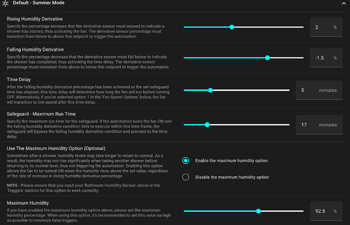

After using this great blueprint now for several weeks, I understand things around the behavior of the humidity etc all a bit better and have my setup dialed in quite well where I am quite happy with it. I experimented a lot, and tried 3 different Humidity sensors until I landed on this one, and countless mounting positions thereof in the ensuite before I was happy with it all.
I thought to share my graphs showing the relationship between humidity, the derivative, and where the fan turns on and off. Since I used these graphs, it made it much easier for myself to understand the nuts and bolts behind it all. I hope this info might help others in turn.

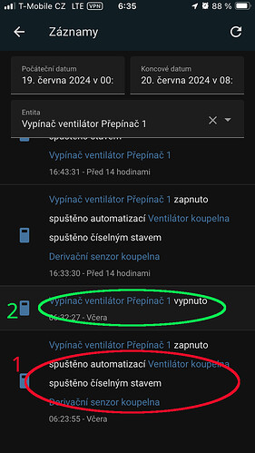

I also found that the automation knows how the switch (controller) was turned on/off. I attach a screenshot of the history of the entity “fan bathroom switch” in HA, (I am translating from Czech):
  1. Fan bathroom switch on, triggered by automation, Fan bathroom switch on, triggered by numeric state Derivative sensor bathroom
  2. Fan bathroom switch, off
    (State 2 is triggered by the manual switch (and interpreted by the controller)).
Thus, it would probably be possible to build this algorithm into your automation:
If the fan is controlled by a controller that allows bypass for a mechanical switch, take into account how the fan was turned on - whether by automation or manually. In case of manual switching, enable “manual_fan_switch” and also “bypass_auto_off_delay”. I don’t know how though - I’ll leave that to an expert :slight_smile: …
