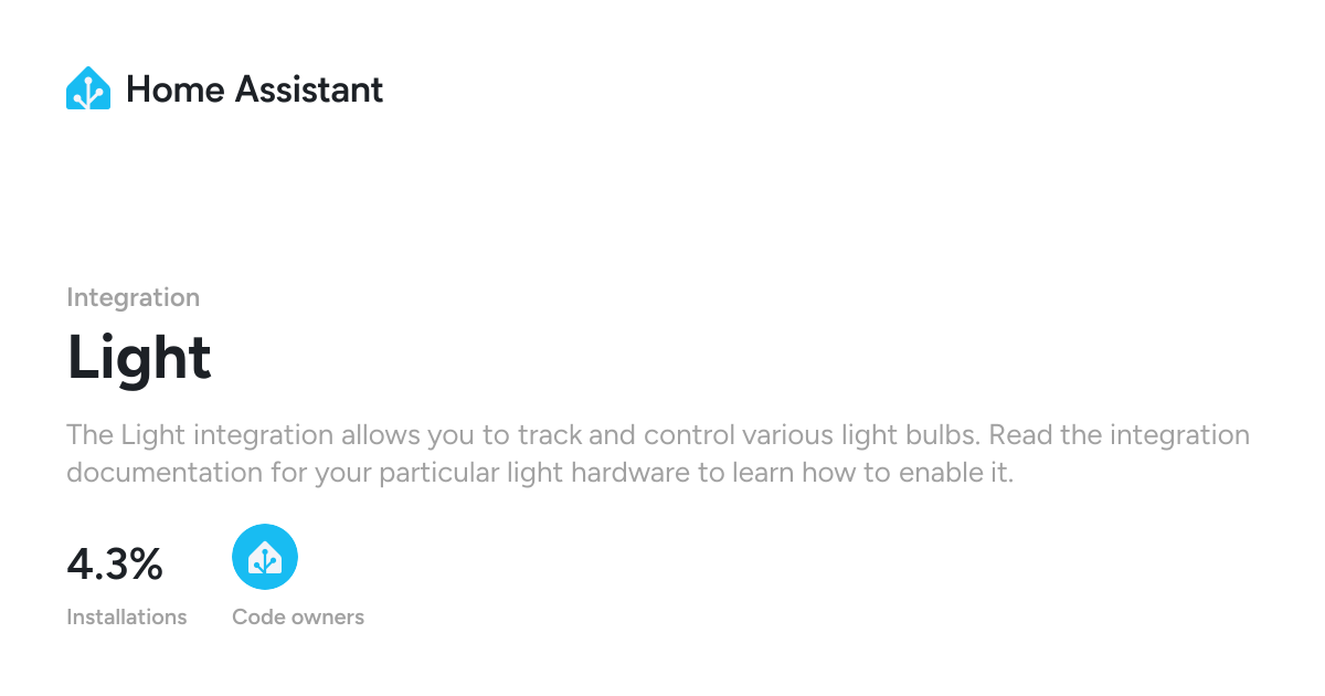

and if you want the default on value for the light, instead of hard coding it here, you may be better to set the default light profile value:
works like a charm
