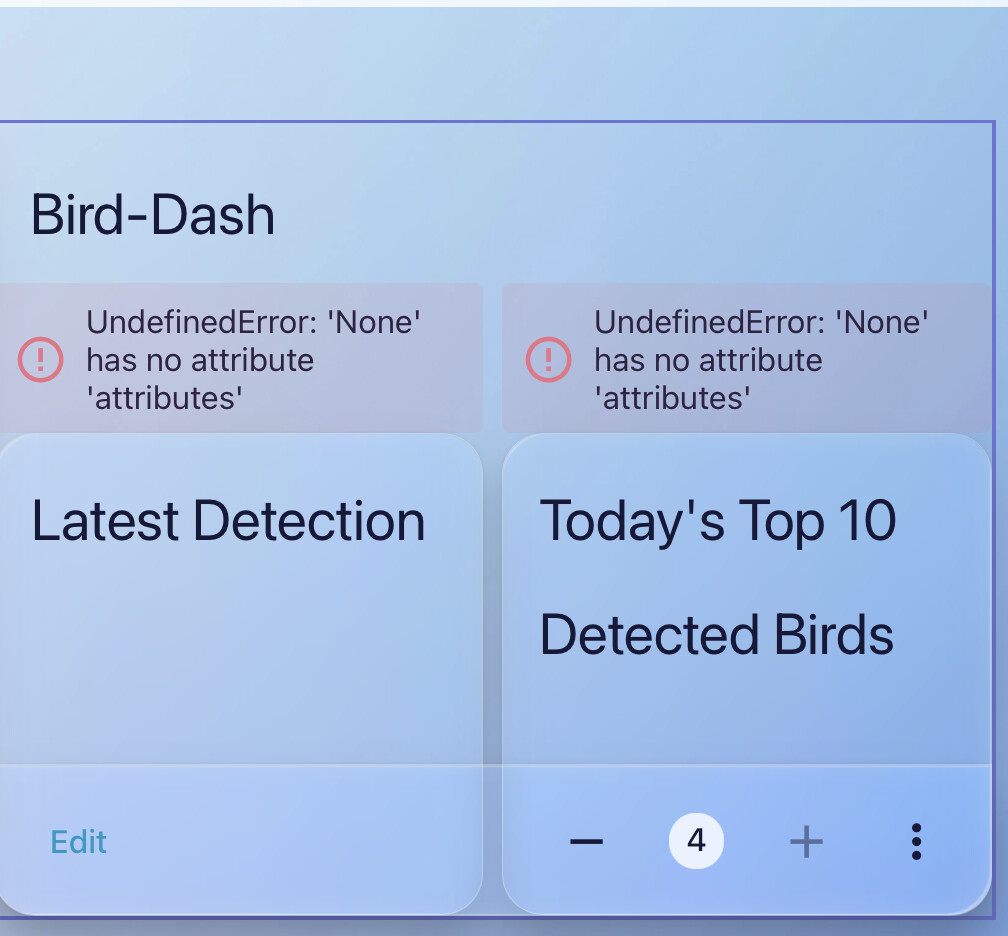

The YAML editor is giving me an error about identation at 4;9 (line 4, position 9), using your Dashboard code – and I am afraid that I don’t use Markdown, so I don’t know where to fix it.[quote=“drharris9121, post:1, topic:742615”]
- path: bird-dash
    type: sections
    sections:
      - type: grid
Grateful for any help!
I was just reading the docs (Markdown card - Home Assistant), which no doubt will make perfect sense as soon as I already know Markdown. :roll_eyes:
I think the problem may be in the sections part of the code above the grid card. I realized I started with a blank dashboard page using the new experimental Sections view type. If you start with a blank page (once in edit mode on the page, click the + in the header to start a new page. I suspect you may be trying to plug that code blob into a custom card. You can do that, but take out the first three lines (through sections:) and then adjust the indents as appropriate. hope that helps.
I had a similar syntax error with the dashboard code when I tried this but managed to get over it with this, slightly adapted, code. It’s a very rudimentary dashboard but I haven’t had the time to format and extend it recently. So, from ‘Show Code Editor’ rather than the UI

I’m trying to add the code but it doesn’t work for me. I added the first part to the configuration.yaml at the bottom and then created the card but it’s empty and it says that None has no attributes.
Any Idea?
can’t put the code because I’m new so it not accepting links but I’m adding your code in the configuration.yaml
`# Loads default set of integrations. Do not remove.
default_config:
Load frontend themes from the themes folder
frontend:
themes: !include_dir_merge_named themes
automation: !include automations.yaml
script: !include scripts.yaml
scene: !include scenes.yaml
Your code here.
Then I create markdown card (also tried manual), putting your card code to code editor and getting errors like I mentioned.
I have the same problem. As @namecaps, I’ve tried to just comment out the lines with imageURL but then nothing appears…
If I check the json file provided by birdweather, everything seems fine and seems passed ok however…
[Edit] I’ve looked further and found that the attribute imageURL was not created. It appears that you have to restart home-assistent for them to be created.
Once that was done; everything came through beautifully!
