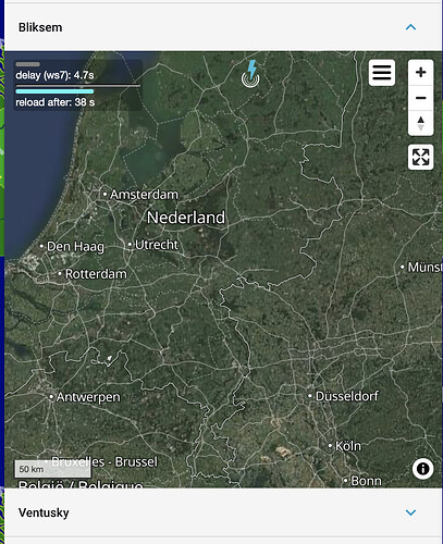

fwiw, adding the live map is cool too, I use Blitzortung.org - Live Lightning Map and do that inside a fold of my weather apps
  - type: custom:fold-entity-row
    head:
      type: section
      label: Bliksem
      card_mod: !include /config/dashboard/card_mods/label.yaml
#     padding: 0
    entities:
      - type: custom:hui-element
        card_type: iframe
        aspect_ratio: 100%
        url: !secret blitz

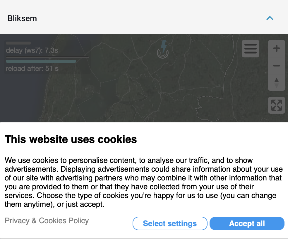

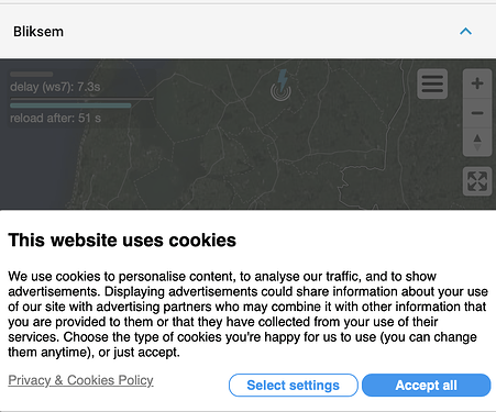

unfortunately it keeps asking for confirmation there, even with &LinksCheckboxChecked=1 in the url…
after click

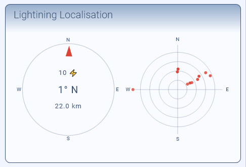

You can turn the other elements (map and history chart) off:

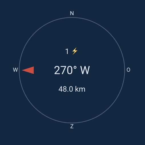

Also the compass card is very similar to the left chart and is highly customisable.
Or do you mean show other data than lightning?
You’d just have to supply a counter an angle and a distance and it can plot anything:
distance: sensor.blitzortung_lightning_distance
counter: sensor.blitzortung_lightning_counter
azimuth: sensor.blitzortung_lightning_azimuth

checking this once more, I finally found the correct syntax to Not show the cookies add:
this is the full url when in the Blitzortung web interface:
https://map.blitzortung.org/index.php?interactive=0&NavigationControl=0&FullScreenControl=0&Cookies=0&InfoDiv=0&MenuButtonDiv=0&ScaleControl=0&LinksCheckboxChecked=1&LinksRangeValue=10&MapStyle=2&MapStyleRangeValue=10&Advertisment=0#3/40/15
so I changed it a bit and deleted some options to use this as my url in secrets
blitz: >
  https://map.blitzortung.org/index.php?Cookies=0&FullScreenControl=0
   &MenuButtonDiv=0&InfoDiv=0&LinksCheckboxChecked=1
   &LinksRangeValue=10&Advertisment=0
   #6.45/52.3/5.5

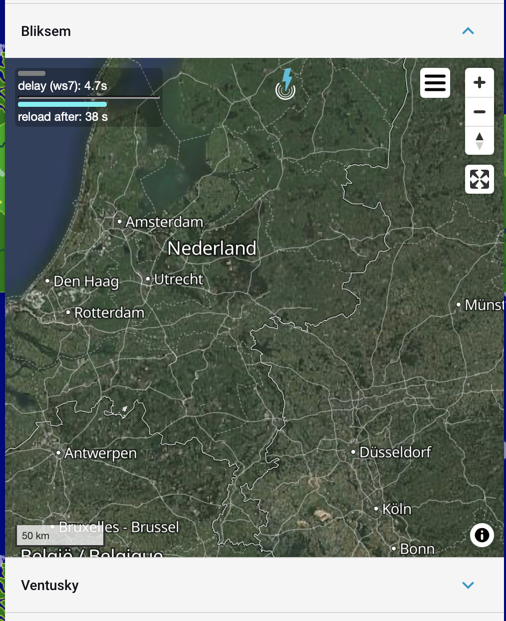

and use it in the fold:
    head:
      type: section
      label: Bliksem
#     padding: 0
    entities:
        card_type: iframe
        aspect_ratio: 100%
        url: !secret blitz
