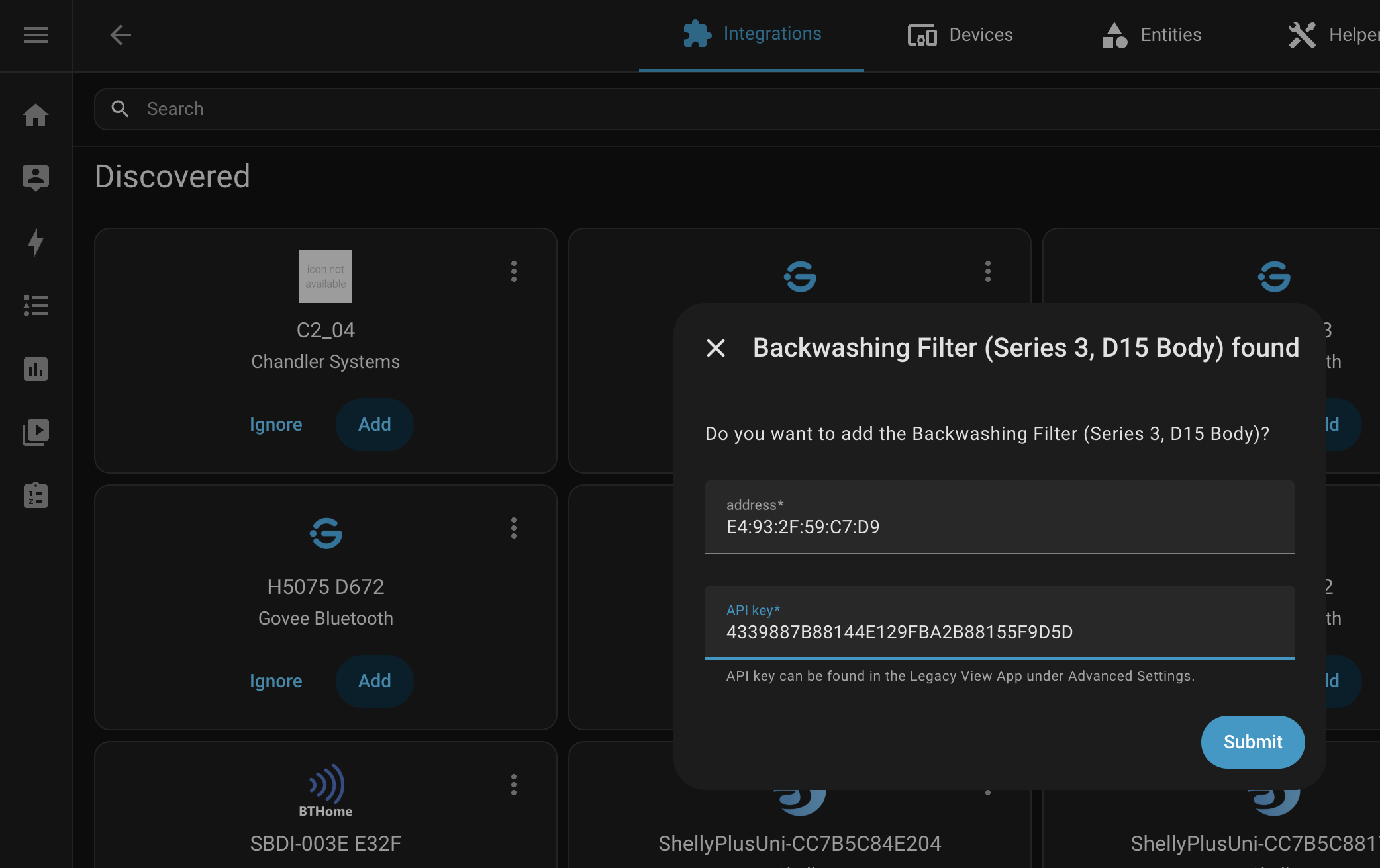

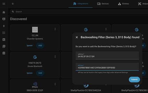

Wanted to give folks an update on where I’m at with an HA integration: I’ve got general happy paths working!
auto-discovery of bluetooth device(s)
configuration of device with API key
overall comms protocol (auth flow, packet and payload decoding/parsing, crc validation, acks/nacks, etc)
automatic time syncing to the device (if it’s out of sync)
bluetooth connection strategy (currently: 60s polling, with a 10s idle timeout. so we’ll maintain an active connection and receive live updates so long as the valve is sending data at least every 10s)
some niceties like displaying valve type and series, serial, firmware version, etc
I’ll aim to package up this WIP as a custom component soon so anyone can start playing around and/or contributing. I do have intentions of getting this into the core HA repo so it can be more easily installed. A few notable things:
  1. I have exclusively tested this via the esphome bluetooth proxy on a dev instance of HA. Once I package it up into a custom component, I’ll install it on my real HA instance and see how it does
  2. I’m still working through some bluetooth connection interruptions. I’m seeing occasional logs where the bluetooth connection or client gets unexpectedly dropped/disconnected and it can leave the bluetooth connection on the valve in a borked state (no new connections can be made). You have to power cycle the valve to restore.
  3. I am currently taking some guesses on which entities are relevant based on the valve type (e.g., salt and aeration related info is not relevant to backwashing filters). James might help us out with a definitive mapping, otherwise we can crowd-source these over time.
Here’s some screenshots of the progress:
Alright, I’ve packaged up my current HA integration as a custom component here: GitHub - toekneestuck/hass_chandler_systems: Custom component for Home Assistant to view and manage Chandler Systems devices
I’ve been running this on my HA instance over the weekend and it’s working reasonably well. There’s one thing to watch out for, and a few things to note:
The thing to watch out for:
I’m still seeing/experiencing random situations where the client and/or esp bluetooth adapter has a hiccup and causes a disconnect from the device. My anecdotal evidence is if this happens during the auth handshake (if the client sends the ID packet, but never sends the auth token), it leaves the device in an unrecoverable state and requires a power cycle to restore. My personal hack has been to plug the device power adapter into a smart plug so i can power cycle remotely :slight_smile:
Notes
  • No logo yet, I apparently have to submit this to the HA brands repo
  • There’s some sensors/data that aren’t returned in the initial response and thus either don’t reset to 0 or are marked unavailable/unknown in HA (e.g., present flow or regeneration active flag)
  • There’s probably some tweaking to be done on the sensor definitions for some items (e.g., state class of total vs total increasing, etc)
  • Probably also some work to do on categorizing the sensors based on valve type (I made educated guesses, along with some help from AI)
  • Everything is read-only for now (besides time syncing)… I’ll work on adding state modifications next
Feel free to open issues or leave feedback here!
