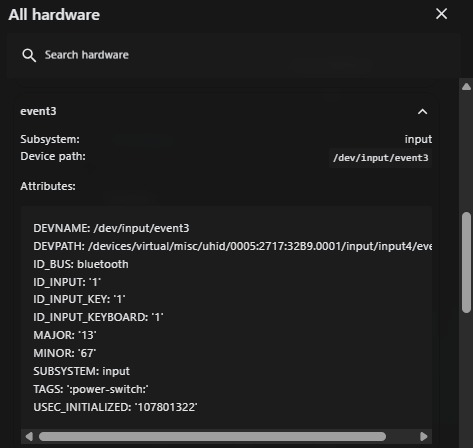

So first i added my bluetooth remote through SSH;
which was kinda difficult to see as the bluetoothctl commend shows you all bluetooth activity in your surroundings.
after succesfully adding the remote i got a new hardware source [ event3 ]

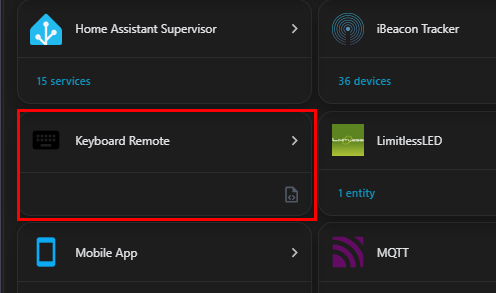

after a reboot you will see the integration: Keyboard remote.

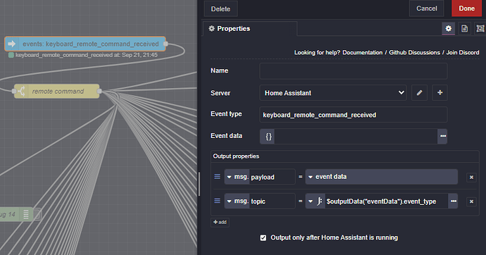

from there you can filter on events and the data that is behind every key press.
i chose to work with Node-Red.

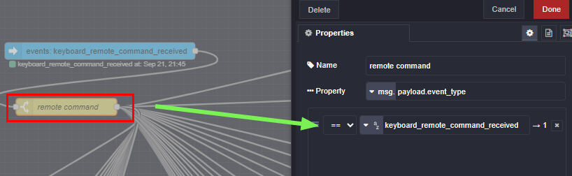

first filtering the recieved “keyboard” remote presses as the data is in the event data you need to set it
mdg.topic= $outputData(“eventData”).event_type
connecting a debugger and reading presses will output the following data:

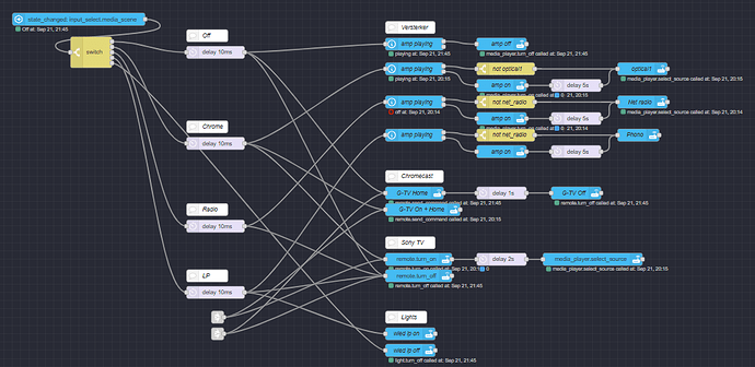

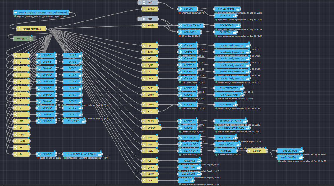

this can be used to make switch nodes. ( i chose to do 1 per keypress )
this resulted in the following flow:
in combination with an input select with media scenes which puts my hardware in the desired setting.
Remote presses:
Scene handling:
