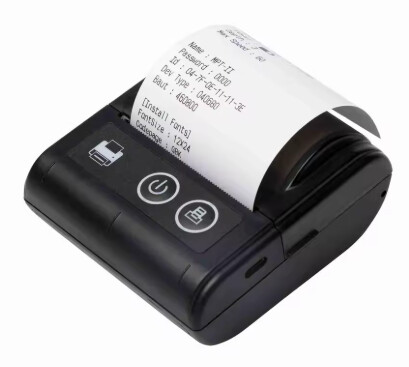

I’d like to integrate a (cheap) Bluetooth printer—like the one shown in the example image—that is typically used for receipts into my Home Assistant setup. I have a use case where I need to trigger a small printout as part of an automation.
Has anyone done something like this before? And does anyone have a recommendation for a suitable printer?
