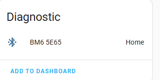

The device has now appeared and it works :+1:
