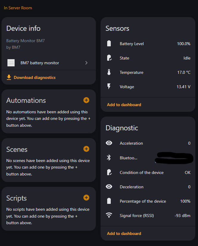

I tested this in a fork, I'm not sure how to integrate this with your project, o… r I would submit a PR.
my fork is here, it seems to work: https://github.com/derekpurdy/BM7
<img width="660" height="819" alt="Image" src="https://github.com/user-attachments/assets/74f1f0f6-6d9b-4d6a-b2d1-90d1087fae3f" />
