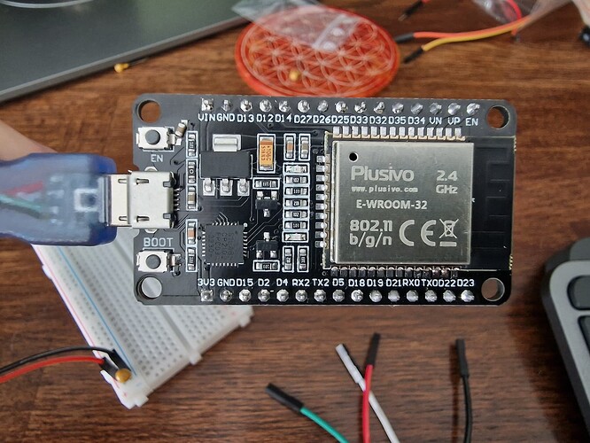

Upload a picture of your esp32 connections and explain your wiring, so we could try to debug it
Wiring? Both cards have micro usb port. When i used the CP2102 USB to UART Converter, i used these pins:
CP2102 USB to UART > 5v > VI ESP
CP2102 USB to UART > GND> GND > ESP
CP2102 USB to UART > TX> RX > ESP
CP2102 USB to UART > RX > TX > ESP
and the other way around.
link: ESP32 Development Board with WiFi and Bluetooth 4.2
Datasheet ESP WROOM 32
I added a level shifter, since the Bosch Climate 5000i AC use 4V+ and the ESP8266 3.3V. The AC still not recognize the ESP.
Any help?

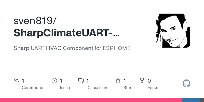

Schould work if Sharp based

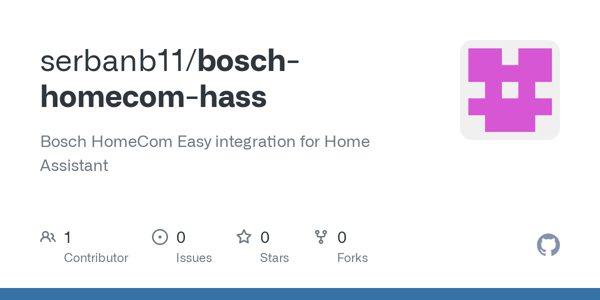

For anyone interested Iāve created a cloud pooling integration that works with Bosch HomeCom Easy app, Iāve tested with my Bosch Climate 6000i ACs
Oh @serbanb11 thank you so much for it! I was looking forward to have something like this! Unfortunately I just bought a SLWF-01 the past week and itās working perfectly, so now I donāt have any Bosch device to test it.

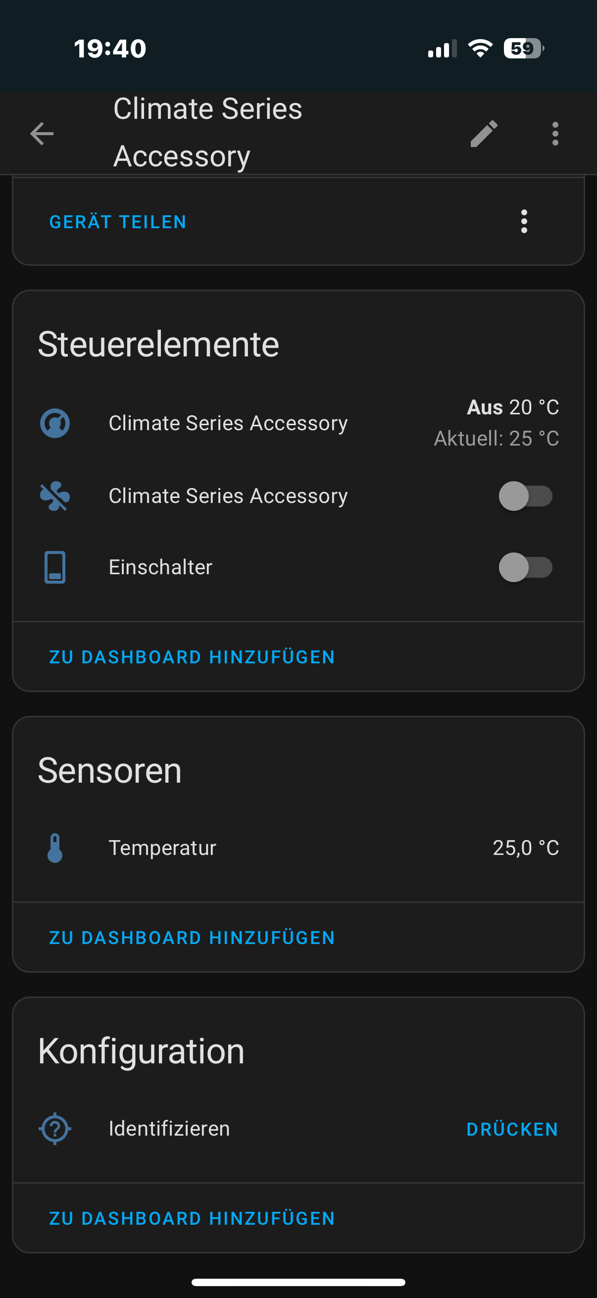

Hi, I connect my 3000i AC with G10-3 Wifi Stick and Matter to my Homeassistant.
This is how it looks like.
Best Regards Andy

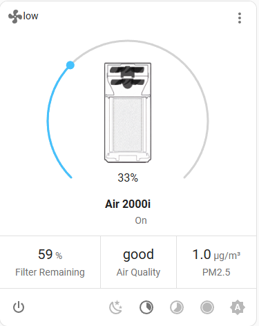

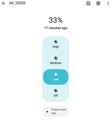

So i could connect my air 2000i using the matter integration but i cannot set it to sleep mode (which runs the ventilator on low and turns off the LEDs on the buttons), the sleep mode just turns off the device completely. I would like to just turn it to the existing night mode like in the bosch app
So the presets are not working correctly and i cannot control the stupid light ring as wellā¦
See:
https://kotzabasis14.hass.de/content/integrate-bosch-air-2000i-4000i-6000i-purifier
Any ideas?

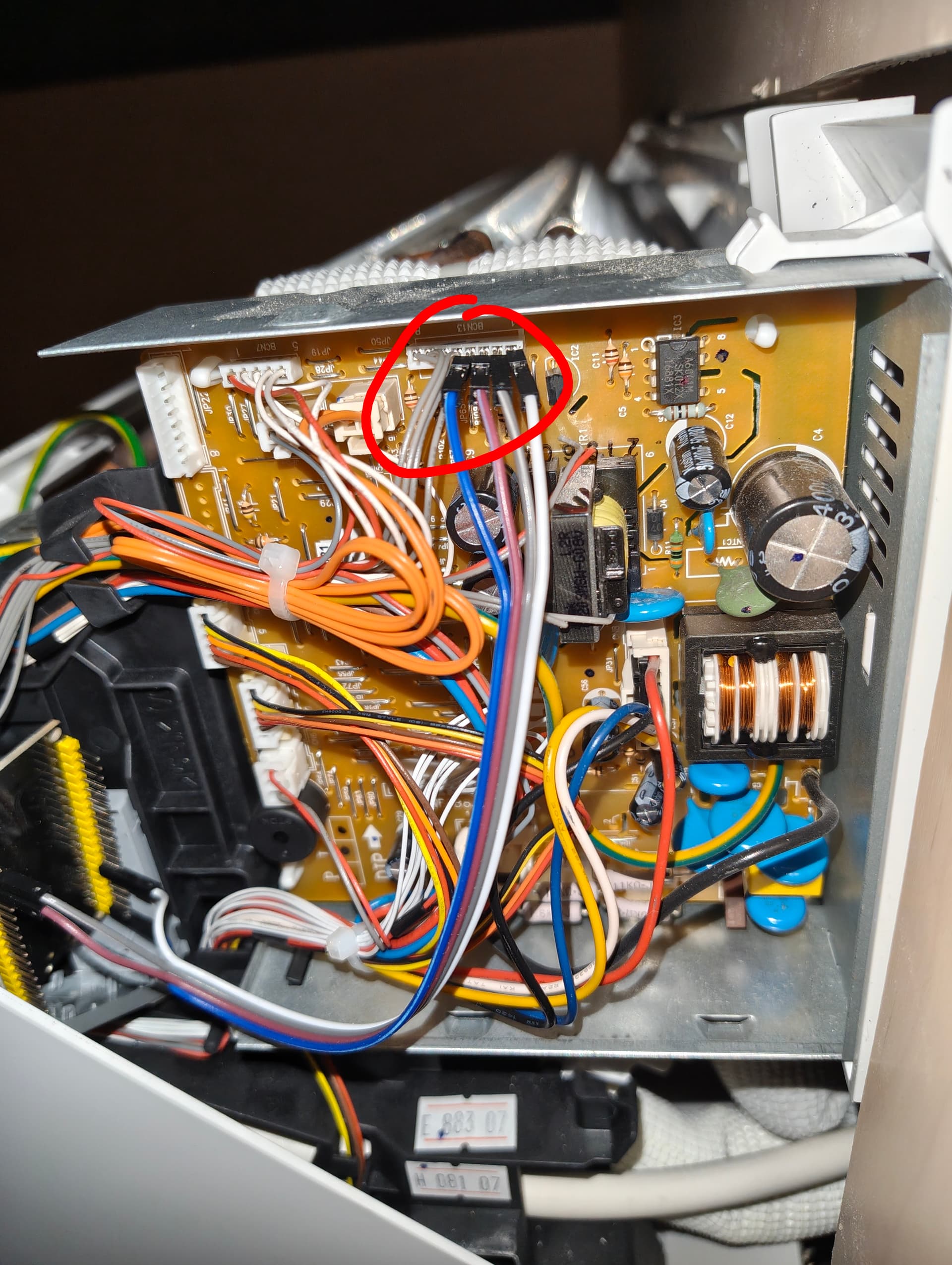

Got this working with the new Bosch Climate 8101i with pre installed Wi-Fi. Opening the indoor unit was a bit difficult, as it is different from the manual of the 8100i.
I flashed an ESP32 with the ESPhome code from Sven and connected the four wires to pins 1 through 4. The pinout is the same on this thing, but the plug is different. It seems to be crimped and soldered directly on. I could pull out the existing cables and use jumpers into the crimp. It seems to hold quite well.
Perfect, could you open a discussion in the repo with pictures and logs that I can also use for the README?
