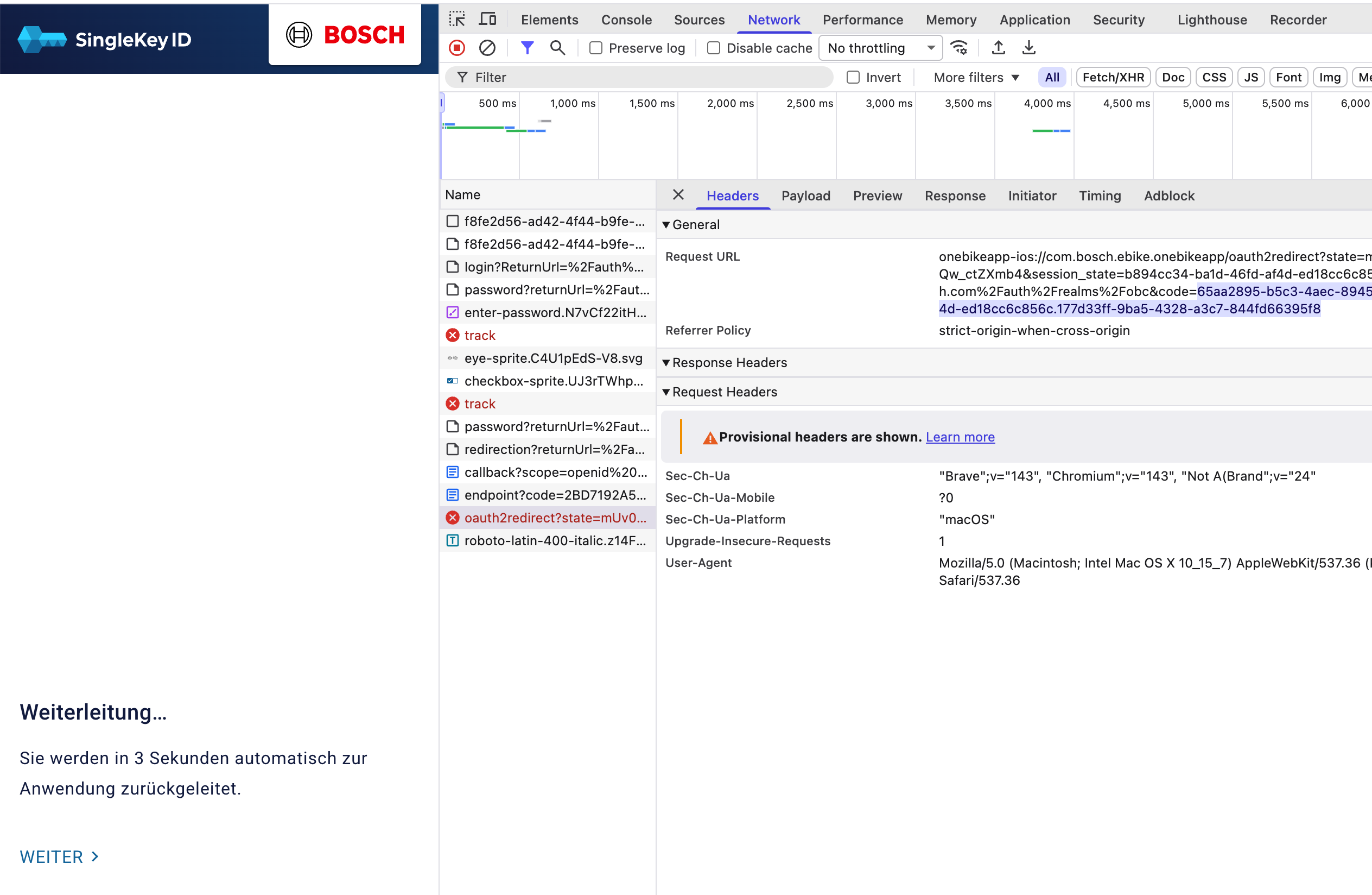

Unfortunately I’m trying to install the app today and can’t seem to use the code in the response is not working.
I noticed that the URL using oauth2redirect:
onebikeapp-ios://com.bosch.ebike.onebikeapp/oauth2redirect?state=XXX&session_state=YYY&iss=ZZZ&code=1a2b3d45-6e78-4f15-b2d9-8c5a0f3e7621.f94d8a3b-7e12-4c86-a5f3-2b9d6e8c1a47.c2f5b8d1-3a94-4e76-b1c8-5d7f9a2e6b34
(code obfuscated)
EDIT: Nevermind, after restarting the workflow from scratch I was able to get a code that worked. I think my request in HA and the request URL I was using in my browser were not aligned after retrying multiple times.

well, I managed it like you have described (developer console …) but after putting my mail + password in I see: “Safari cannot open the page because the address is invalid.”
No “onebikeapp-ios//…Url” in Network tab.
I tried it 100 times…may more :wink:
Any idea?
thx in advance!
Same here. No chance in Safari. I tried Firefox. It shows:
onebikeapp-ios://com.bosch.ebike.onebikeapp/oauth2redirect?state= …
but not code
It doesn’t work
Hier sieht man den Code markiert (ist abgeschnitten), so ging es bei mir

I installed the integration, followed the link for the login. I don’t get an url with this token, there is something code_challenge challenge_method the URL is Misconfigured Application - SingleKey ID? like this.
[Edit] WIth firefox I was able to get the correct code, Chrome didn’t want to work for me. [/edit]
