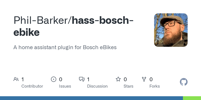

Turned out to be quicker than I thought
All done and working
You can add a custom repo to HACS and install if you’d like to test - but sadly you will need a connectModule and Flow+ subscription
This may change in the future if Bosch get more open with their API’s - we’re having to hijack mobile app functionality to make this work - but for now that’s the only use case that will work.

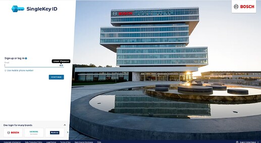

I really don’t know what you mean.
This is the login screen I get,
I don’t see developer tools.

Developer tools is in the browser
If you’re in Edge or Chrome press F12
Then across the top you’ll see a tab for Network
In there you can see what network requests the page is trying to do
Because the only way to do this at the moment is to pretend to be the iOS app - you have to look for where it tries to redirect back to onebikeapp-ios://… and fails - then copy the code from it
