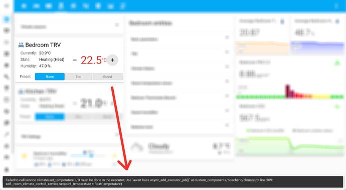

Hi all.
After some updates I faced with the issue. It’s impossible to change the TRV temperature using this integration anymore. Every time I change the temperature using thermostat card I see the error:
I/O must be done in the executor; Use `await hass.async_add_executor_job()` at custom_components/boschshc/climate.py, line 209:
It’s also impossible to change the temp using service:
climate.set_temperature
Here is the screenshot:
Does anyone faced this issue?
@vigilcoma I guess you are using an old version of the custom component. Please update your custom component and try again. The easiest way is to delete the folder custom_components/bosch_shc
and install the current version either via HACS or pull the current master. The current version is 0.3.3.
