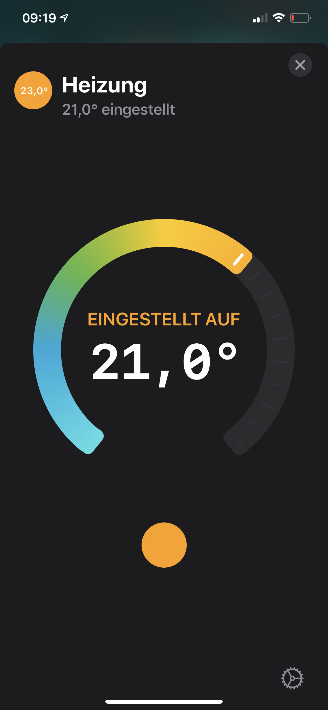

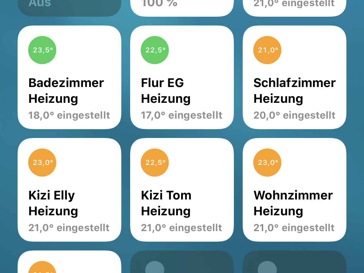

Works perfekt out of the Box thanks so much for your Work.
And now my thermostat are in HomeKit.

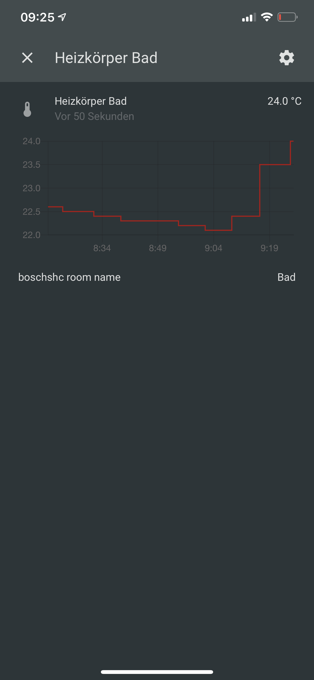

I have several smoke detectors installed. Is there any way to distinguish them so that I can allocate them to rooms? Seems that no devide ID or BHC room allocation is displayed with the entity.
Edit: I found a way to find out the room name. You need to add one of the smoke detector entities to a card in lovelace. If you select the entity, it will display the associated SHC room name.
