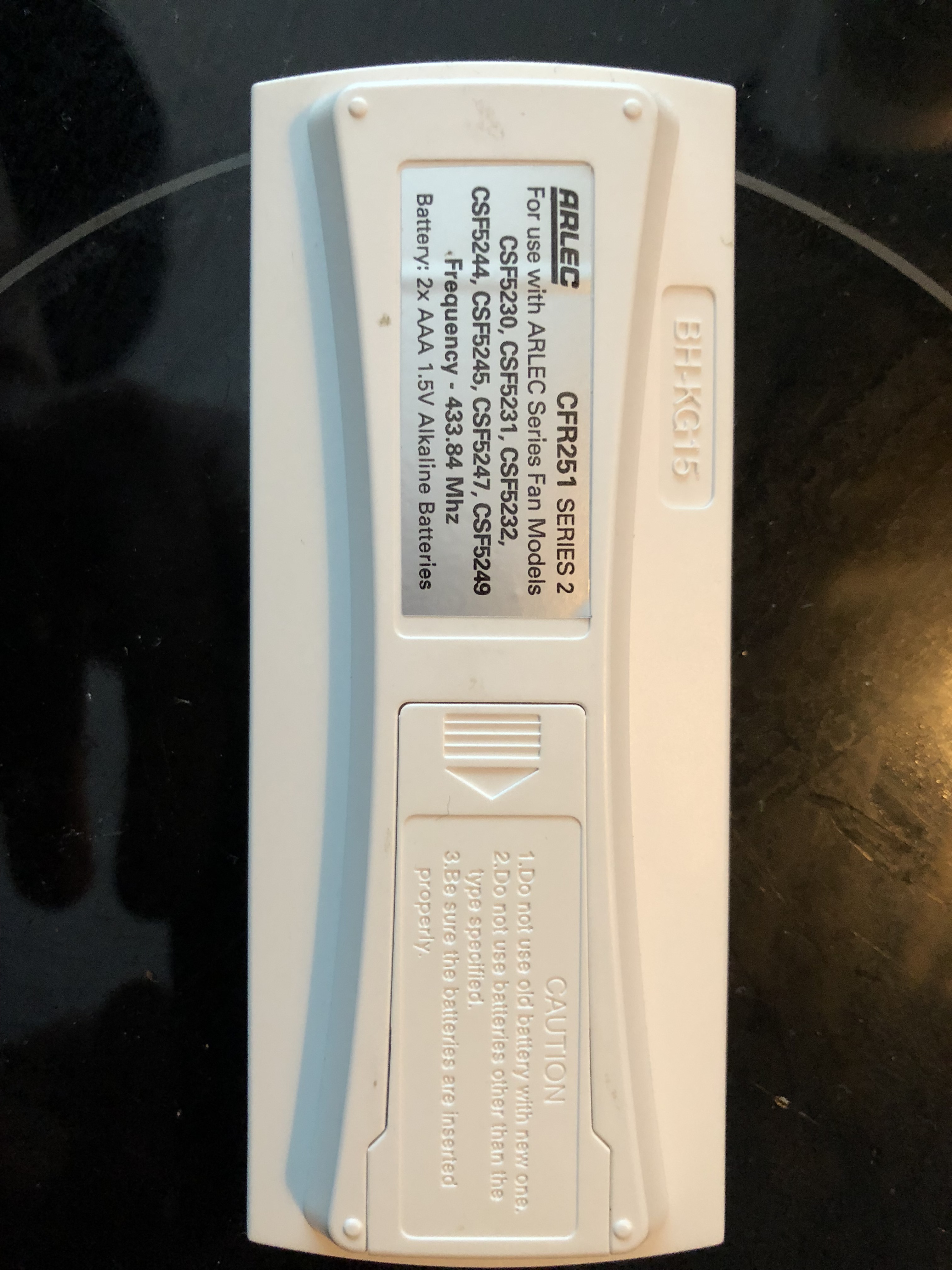

Are there some remote controls that cannot be added to home assistant or maybe even the broad link device?
I struggled with one remote for an Arlec Air Conditioner, I captured multiple clicks off the remote and compared them and they are quite different.
Output from script for the same button (which has worked great for other devices, thanks)

I think some use a rolling code, so those won’t work :frowning:
That sounds likely, thanks.
