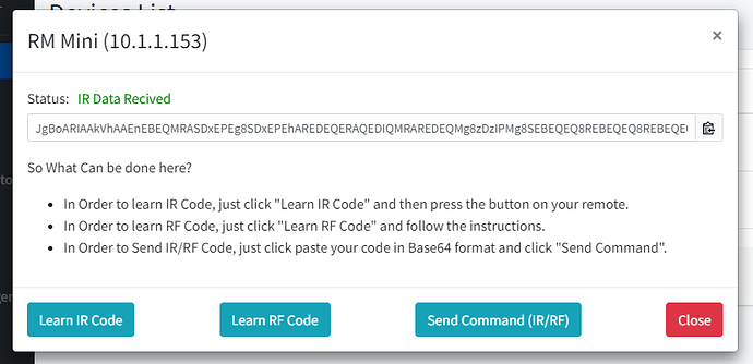

Am I missing something here? I can apparently learn an RF code successfully according to the web interface, but where do I see the code? It isnāt displayed anywhere that I can tell. The screen grab below was using an RM4 Pro (0x649b). It asked for a long press which was successful, I clicked āContinue Scanningā and it asked for a single press after which the status changed to that in the screen grab.
I get a similar result when learning an IR code on an RM3 mini, the status message says that IR data was received but again where is the code?
Hi @walkie
Are you using ad blocking system like AdGuard or Pi-Hole?
Iām using google analytics in the container and it might be that the ad blocker is blocking google script
and causing script errors.
Please try working without ad blocker and see if itās working.
I will remove the google analytics on the next major release.
Cheers!
Hi @Tomer_Klein
Yes that was the cause. Disabled pihole, restarted the container, refreshed the page and away it went.
I personally have no issue with the analytics, I understand that youād want to know where and how and how often it was being used etc. Perhaps advise users to temporarily disable adblockers.
Anyway thanks for solving my issue and thanks for a really useful tool.
