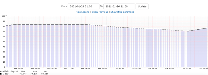

Unbenannt
Having a look at the above results from a ping device there seems to be a scheme, 6 minutes disconnected, 2 minutes connected…
I’ve updated the firmware to the newest available, but same issue. Is anyone elses experiencing this or is able to give some suggestion to fix this?

I’ve discover that the time between disconnections depends on “Enable GTK rekeying every” value. I changed from 3600s (1hr) to 1800s and you can see the effect:
Also, downsizing to 1800, other devices began to disconnect, so I’ll make some tests to find the correct value.
