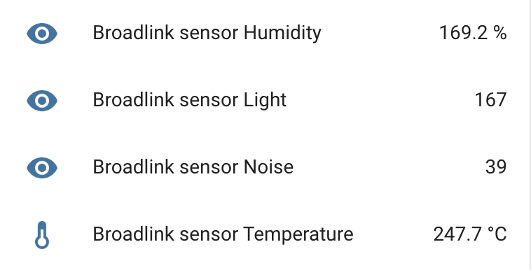

The unrealistic values are probably some hardware issue, and I am not sure how much we can do with it. We could implement a filter that reject the value if it is unrealistic. A pull request to fix that is welcome.
The other issue seams to be related to some network problem. But it should not stop HA or be of any big problem, they will just delay the update of the device. You can try to increase the timeout from the config.
