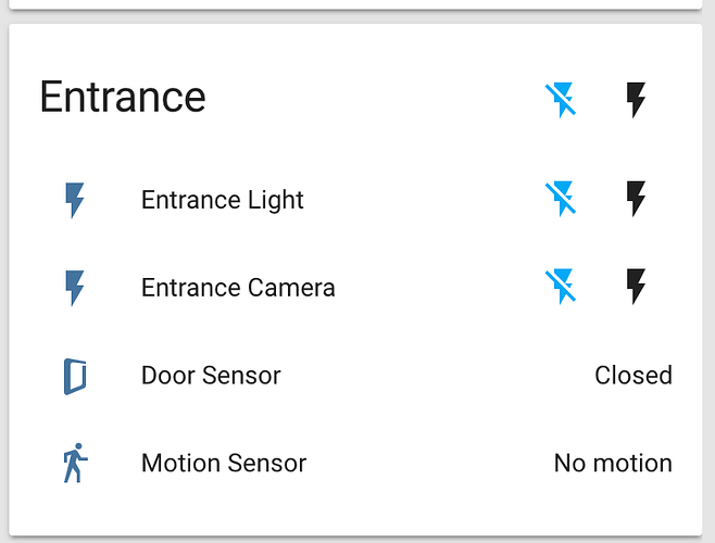

In my setup, I have the S1C Kit which includes only 1 door magnet sensor and 1 motion PIR sensor
First, I used the broadlink e-Control app to add the device and sensors, then I wrote a simple python script which runs in the background, gets the sensors data and publish the data via MQTT.

Screenshots:
