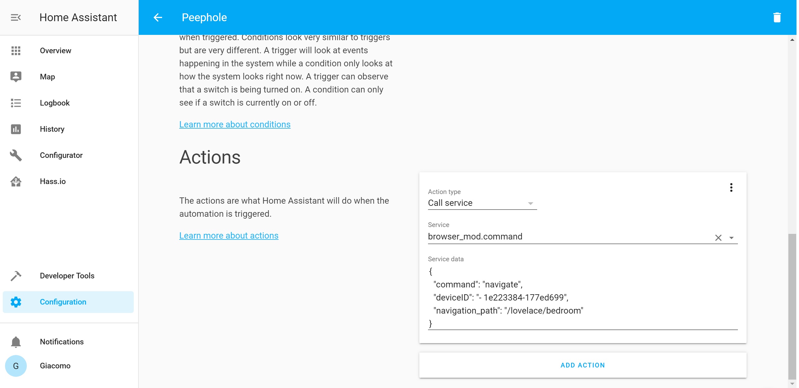

At this point I built an automation to navigate to a given page when an event occurs.
Fine… it works perfectly
Here is the screen printout of the lower part of the working automation:
All devices switch to the right page when the automation is triggered

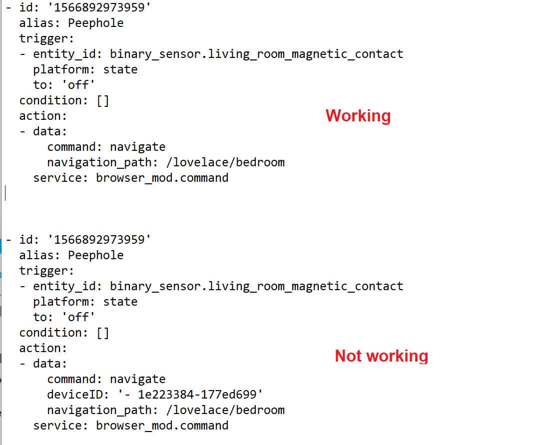

Next step… I tried to send the navigate to a single device… and here is how I modified the automation:
When this automation is triggered nothing happens … no errors no navigation to the desired page.
Of course I tried in several different ways, (deviceID, easy name. with dash, without dash) always within the limits allowed by the user interface, No way
If it may help, here are the automations as I find them in automation.yaml:
What am I doing wrong?
Thanks for listening
Giacomo
deviceID is supposed to be a list. Yours is a string.

Thanks a lot Thomas.
I thought I had already tried all the combinations but reading your guide pushed me to try in a way that I probably skipped before:
“command”: “navigate”,
“deviceID”: [
“1e223384-177ed699”
“navigation_path”: “/lovelace/cameras”
Now I wil have to understand why when I change the self generated deviceID with the easy name the automation won’t work:
“deviceID”: [
“media_player.pad_giacomo”
I’ll try to read again and with more care your guide, but should you have a hint, please let me know
Thanks again
Giacomo
Example of alias used in service call: https://github.com/thomasloven/hass-browser_mod#more-info
