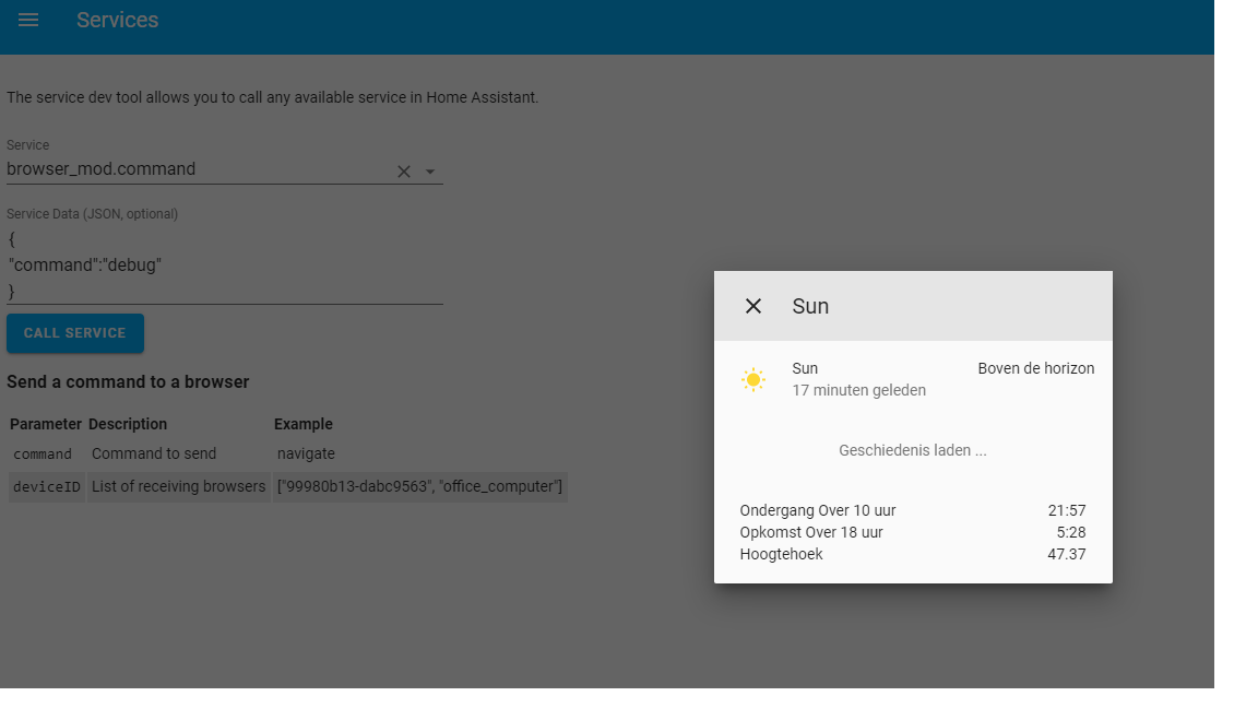

Tried the debug in dev-service to find the deviceid, but got info about ā€œsun.sunā€ after hitting the set state button…
EDIT: strange, seems to work correctly now
that is a strange one, I have the same thing on one of my PCs. I can send a screen popup to two machines and on one I get the expected result the other i get sun.sun.
Try to clear cache (CTRL-F5) on every PC.

i cant find the device id, i did clear the cache, i’m trying thru services to get the id as ā€œRikkie80ā€ have suggested above but no response when i call the service, any suggestions?
Actually I did that, but I work on a half dozen desktops and being early I didn’t see or remember the 5 extra browsers I had open on other desktops… doh :face_palm:
working now
when you call the service use this as your service data:
  "command": "debug"

When using the services tab and running the debug command I get the Sun card every time on chrome.
It works on firefox.
-------------------------------EDIT--------------------------------------------------------
Okay I tried a different PC and it works with chrome.
On the one not working I tried the CTRL + F5 and closed and reopened and no difference. Both say they are up to date versions of chrome so who knows.
I had to go into the chrome settings and clear the cache for thins to work properly. But its working fine now on all my devices.
You should have also gotten a javascript alert with the deviceID.
Unfortunately, the popup window depends on the popup-function, which doesn’t always work when you’re on pages other than /lovelace.
It might help to first go to /lovelace and then go back to /dev-service without reloading the page.
