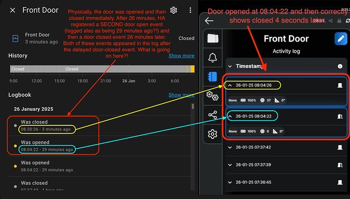

Here’s a demonstration in my HA logs that literally just happened, that shows exactly what I’m referring to. Just to be clear, the door physically opened at 08:04:22, and was closed almost immediately afterwards at 08:04:26 (i.e. the door was only open for about 4 seconds). 26 minutes after the door was closed, HA finally registered the door closed event at 08:30:36 and at the same time it registered a SECOND door open event at 08:04:22. So this data is getting backlogged somewhere in HA.
The shelly app log (right hand side of screenshot) shows the door open/closed event at the correct times, when it actually physically happened - again supporting the fact this isn’t a sensor problem, nor a BLE radio issue.
