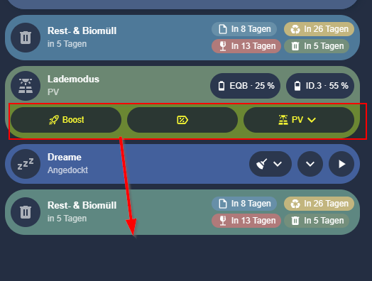

I have a few bubble cards with the small sub buttons. See screenshot below.
Is it possible to have those small sub buttons as you can see in the “Rest & Biomüll” card, and then have another row with bigger sub buttons as you can see in the “Lademodus” card?
The small sub buttons (“In 8 Tagen”, “in 26 Tagen” etc.) are supposed to be used for information only, and than I would like to have 3-5 separate bigger sub buttons in a row below.
I tried creating groups, but wasn’t able to achieve what I want to achieve. Maybe I’m missing something.
Thanks in advance!
Edit: Not sure if that will work with bubble card on its own. I have now used a stack-in-card and with that I can achieve that:

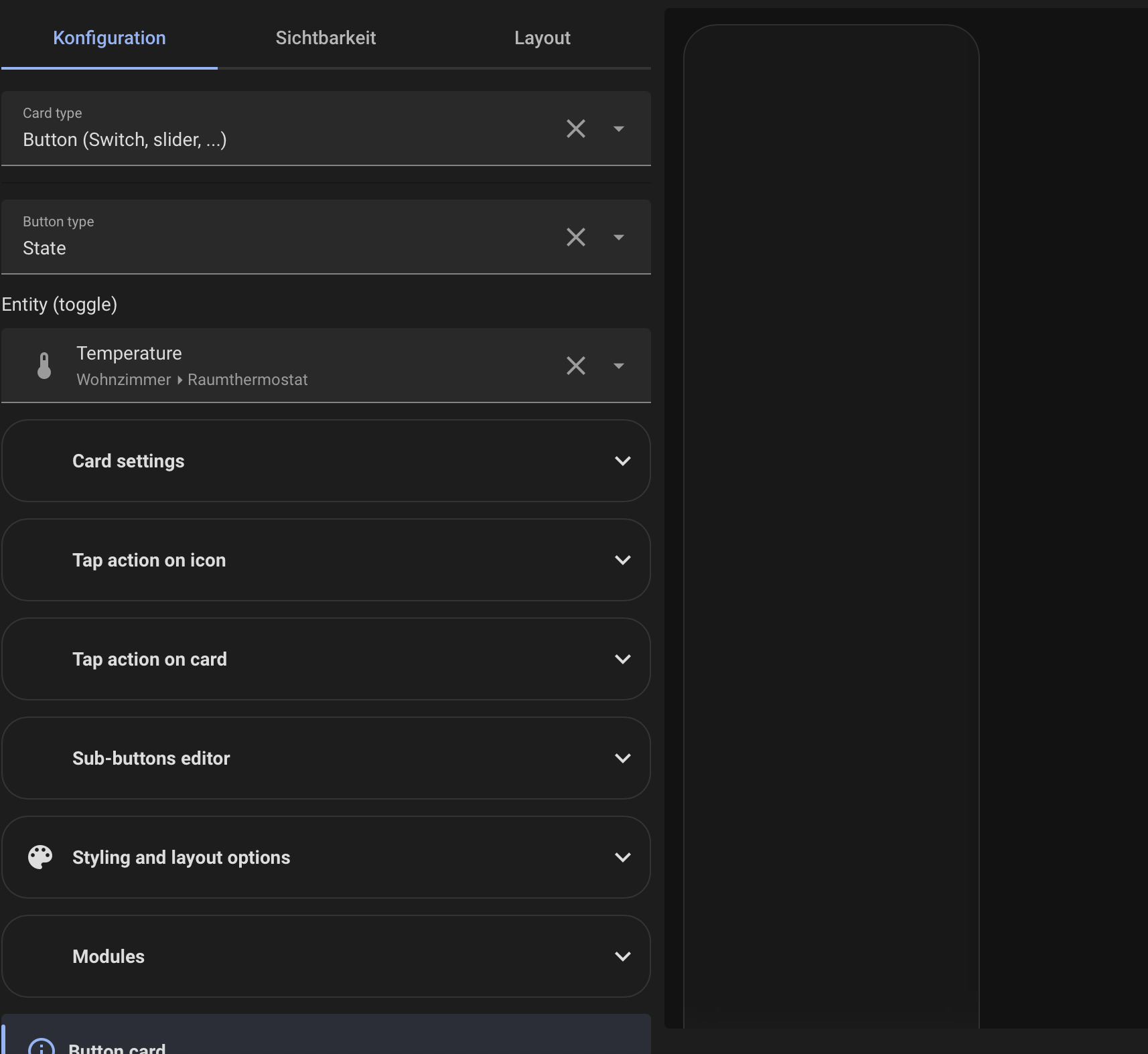

I’m having a problem with my bubble cards. When I try to edit them in the editor, they keep getting longer and Safari or Chrome freezes. I can’t edit anything.

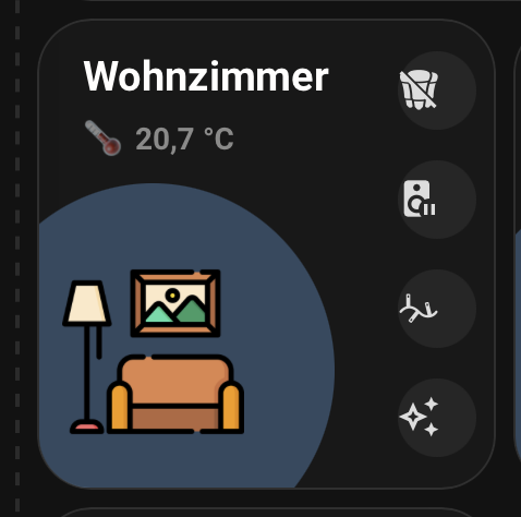

type: custom:bubble-card
card_type: button
entity: sensor.raumthermostat_temperature
show_attribute: false
show_name: true
show_icon: true
scrolling_effect: true
show_state: true
double_tap_action:
  action: navigate
  navigation_path: "#szenenWZ"
card_layout: large-2-rows
button_action:
  tap_action:
    action: navigate
    navigation_path: "#wohnzimmer"
tap_action:
  action: navigate
button_type: state
icon: "no"
sub_button:
  main:
    - entity: light.wohnzimmer
      show_last_changed: false
      show_state: false
      tap_action:
        action: toggle
      show_background: true
      hold_action: {}
      double_tap_action: {}
      name: Lampen Wohnzimmer
    - show_last_changed: false
      show_state: false
      show_name: false
      tap_action:
        action: toggle
      entity: input_boolean.1
      double_tap_action:
        action: navigate
        navigation_path: "#mediaplayerwohnzimmer"
      icon: ""
      name: Sonos Wohnzimmer
    - entity: switch.lichterkette_balkon
      tap_action:
        action: toggle
      hold_action: {}
    - entity: switch.steckdose_sterne
      tap_action:
        action: toggle
      double_tap_action:
        action: {}
      hold_action:
        action: {}
      name: Sterne Lichterkette
  bottom: []
styles: >
  :host{
      --icon-Background-Color: rgba(79, 148, 205, 0.4);
      --color-yellow: 255, 202, 58;
      --color-blue: 25, 130, 196;
      --color-green: 138, 201, 38;
      --color-purple: 106, 76, 147;
      --color-purple1: 233, 53, 157;
      --color-blue1: 53, 205, 233;
  .card-content {
    width: 100%;
    margin: 0 !important;
  .large .bubble-button-card-container {
    height: calc(var(--row-height) * var(--row-size) + var(--row-gap) * (var(--row-size) - 1)) !important;
    overflow: hidden !important;
    background: rgba(30, 30, 30, 0.5) !important;
    backdrop-filter: blur(12px) !important;
    -webkit-backdrop-filter: blur(12px) !important;
    border-radius: 25px !important;
    border: 1px solid rgba(255, 255, 255, 0.1);
  .bubble-button-card {
    display: grid;
    grid-template-areas:
      'n n n b'
      'l l l b'
      'i i . b'
      'i i . b';
    grid-template-columns: 1fr 1fr 1fr 1fr;
    grid-template-rows: 1.5fr 0.5fr 1fr 1fr;
    justify-items: center;
    position: relative;
  .bubble-icon-container {
    grid-area: i;
    border-radius: 50% !important;
    width: 160% !important;
    height: 160% !important;
    max-width: none !important;
    max-height: none !important;
    position: absolute !important;
    place-self: center !important;
    margin: 0px 0px 0px 0px !important;
    padding: 0px, 0px, 0px, 0px !important;
    background-color: var(--icon-Background-Color);
    background-image: url("/local/interior-design.png") !important;
    background-size: 50%;
    background-repeat: no-repeat;
    background-position: 50% 40%;
  .bubble-icon {
    width: 0%;
    position: relative !important;
    --mdc-icon-size: 100px !important;
    opacity: 0.5 !important;
  .bubble-name-container {
    grid-area: n;
    justify-self: start;
    margin-left: 20px;
    max-width: calc(100% -(12px + 0px));
    gap: 10px !important;
    color: #fffefd;
  .bubble-name {
    font-weight: bold;
    font-size: 19px;
  .bubble-state {
    font-weight: bold;
    font-size: 14px;
    filter: opacity(70%);
  .bubble-state::before {
    content: "🌡️";
    margin-right: 5px;
  .rows-2 .bubble-sub-button-container {
    grid-area: b;
    display: flex !important;
    flex-wrap: wrap;
    flex-direction: column;
    gap: calc((100% - 4 * 36px)/5) !important;
    justify-content: flex-start;
    width: auto !important;
    right: 0px !important;
    padding-right: 0px !important;
    height: 100% !important;
    top: calc((100% - 4 * 36px)/5) !important;
  .rows-2 .bubble-sub-button {
    height: 36px !important;
    width: 36px !important;
    padding: 0 !important;
    background: rgba(255, 255, 255, 0.05) !important;
    backdrop-filter: blur(6px) !important;
    transition: all 0.3s ease;
  .rows-2 .bubble-sub-button:hover {
    background: rgba(255, 255, 255, 0.15) !important;
    transform: scale(1.1);
    min-width: 36px !important;
  .bubble-sub-button-1 {
    background-color: rgba(var(${hass.states['light.wohnzimmer'].state === 'on' ? '--color-yellow' : '255,255,255'}), 0.3) !important;
    box-shadow: ${hass.states['light.wohnzimmer'].state === 'on' ? '0 0 12px rgba(var(--color-yellow), 0.8)' : 'none'} !important;
    color: rgba(var(${hass.states['light.wohnzimmer'].state === 'on' ? '--color-yellow' : '255,255,255'}), 1) !important;
  .bubble-sub-button-2 {
    color: rgba(var(${hass.states['input_boolean.1'].state === 'on' ? '--color-blue1' : '255,255,255'}), 1) !important;
    background-color: rgba(var(${hass.states['input_boolean.1'].state === 'on' ? '--color-blue1' : '255,255,255'}), 0.3) !important;
    box-shadow: ${hass.states['input_boolean.1'].state === 'on' ? '0 0 12px rgba(var(--color-blue1), 0.8)' : 'none'} !important;
  .bubble-sub-button-2 .bubble-sub-button-icon{
    animation: ${hass.states['input_boolean.1'].state === 'on' ? 'sound 0.8s infinite' : 'none'} !important;
  .bubble-sub-button-3 {
    color: rgba(var(${hass.states['switch.lichterkette_balkon'].state === 'on' ? '--color-purple1' : '255,255,255'}), 1) !important;
    background-color: rgba(var(${hass.states['switch.lichterkette_balkon'].state === 'on' ? '--color-purple1' : '255,255,255'}), 0.3) !important;
    box-shadow: ${hass.states['switch.lichterkette_balkon'].state === 'on' ? '0 0 12px rgba(var(--color-purple1), 0.8)' : 'none'} !important;
  .bubble-sub-button-3 .bubble-sub-button-icon {
    animation: ${hass.states['switch.lichterkette_balkon'].state === 'on' ? 'bounce 0.6s cubic-bezier(0.30, 2.40, 0.85, 2.50) infinite' : 'none'};
  @keyframes bounce {
    0%, 100% { transform: translateY(0px) scaleY(0.9); }
    80% { transform: translateY(-3px); }
  @keyframes sound {
    0% { transform: scale(1); }
    50% { transform: scale(1.05); }
    100% { transform: scale(1); }
  .bubble-sub-button-4 {
    color: rgba(var(${hass.states['switch.steckdose_sterne'].state === 'on' ? '--color-yellow' : '255,255,255'}), 1) !important;
    background-color: rgba(var(${hass.states['switch.steckdose_sterne'].state === 'on' ? '--color-yellow' : '255,255,255'}), 0.3) !important;
    box-shadow: ${hass.states['switch.steckdose_sterne'].state === 'on' ? '0 0 12px rgba(var(--color-yellow), 0.8)' : 'none'} !important;
  .bubble-sub-button-4 .bubble-sub-button-icon{
    animation: ${hass.states['switch.steckdose_sterne'].state === 'on' ? 'shake 10s infinite' : 'none'} !important;
  @keyframes shake {
    0% { transform: translate(0px, 5px) rotate(0deg); }
    25% { transform: translate(-5px, 0px) rotate(-45deg); }
    50% { transform: translate(0px, -5px) rotate(0deg); }
    75% { transform: translate(5px, 0px) rotate(45deg); }
    100% { transform: translate(0px, 5px) rotate(0deg); }
  ${subButtonIcon[0].setAttribute("icon", hass.states['light.wohnzimmer'].state
  === 'on' ? 'hue:bulb-group-sultan-3' : 'hue:bulb-group-sultan-3-off')}
  ${subButtonIcon[1].setAttribute("icon", hass.states['input_boolean.1'].state
  === 'on' ? 'mdi:speaker-play' : 'mdi:speaker-pause')}
  ${subButtonIcon[2].setAttribute("icon",
  hass.states['switch.lichterkette_balkon'].state === 'on' ? 'hue:festavia' :
  'hue:festavia')} ${subButtonIcon[3].setAttribute("icon",
  hass.states['switch.steckdose_sterne'].state === 'on' ? 'mdi:creation' :
  'mdi:creation-outline')}
force_icon: true
layout_options:
  grid_columns: 2
  grid_rows: 3.5

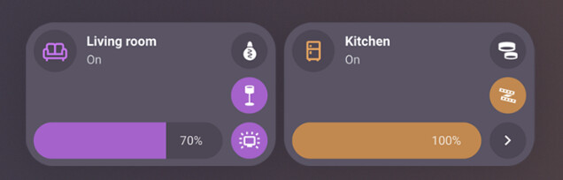

First thanks @Cloos for the great work on this cards ! I really enjoy the customizability
Is there a way to conditionally deactivate a slider ?
Below are screenshots of a bubble-card button to control a light with a slider.
I don’t like when the slider takes over the full button, so I changed that in the styles.
The button tap action is set to nothing, and indeed nothing happens when tapping on the card.
However when the light is off, if you swipe the finger on the card, the light will turn on. Either at minimum brightness or some brightness, depending how you swipe. Despite my best efforts, it seems the slider is still active.
I would like to completely deactivate the slider when the light is off. Is it possible ?
display: none and pointer-events: none are not enough.
When light off, slider hidden
when light on, slider visible with the range background
Code
card_type: button
button_type: slider
entity: light.lampe_1
tap_action:
  action: toggle
button_action:
  tap_action:
    action: none
  hold_action:
    action: none
show_state: true
show_attribute: true
show_background: false
attribute: brightness
slider_value_position: left
light_slider_type: brightness
step: 10
min_value: 10
max_value: 100
sub_button:
  main:
    - entity: light.lampe_1
      icon: mdi:information
      state_background: false
      content_layout: icon-left
  bottom: []
rows: 1
card_layout: large
styles: |
  /* ── Brightness Slider ── */
  /* ── 1. card container position relative ── */
  /* It is relative by default. This is just to ensure */
  /* ── 2. slider height, position and display ── */
  .bubble-range-slider {
    bottom: 2px !important;
    top: auto !important;
    left: 60px !important;
    right: 56px !important;
    height: 10px !important;
    border-radius: 5px !important;
    /* show range background */
    background: rgba(16.8, 16.8, 16.8, 0.8) !important;
    /* hide slider when light is off */
    display: ${state === 'on' ? 'flex' : 'none'} !important;
    /* attempt to deactivate slider when light is off */
    pointer-events: ${state === 'on' ? 'auto' : 'none'} !important;
  /* ── 3. slider filling ── */
  .bubble-range-fill {
    border-radius: 0px !important;

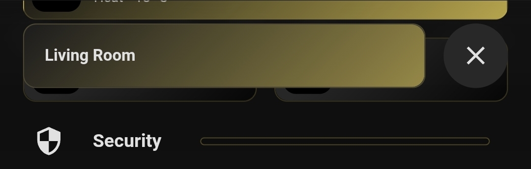

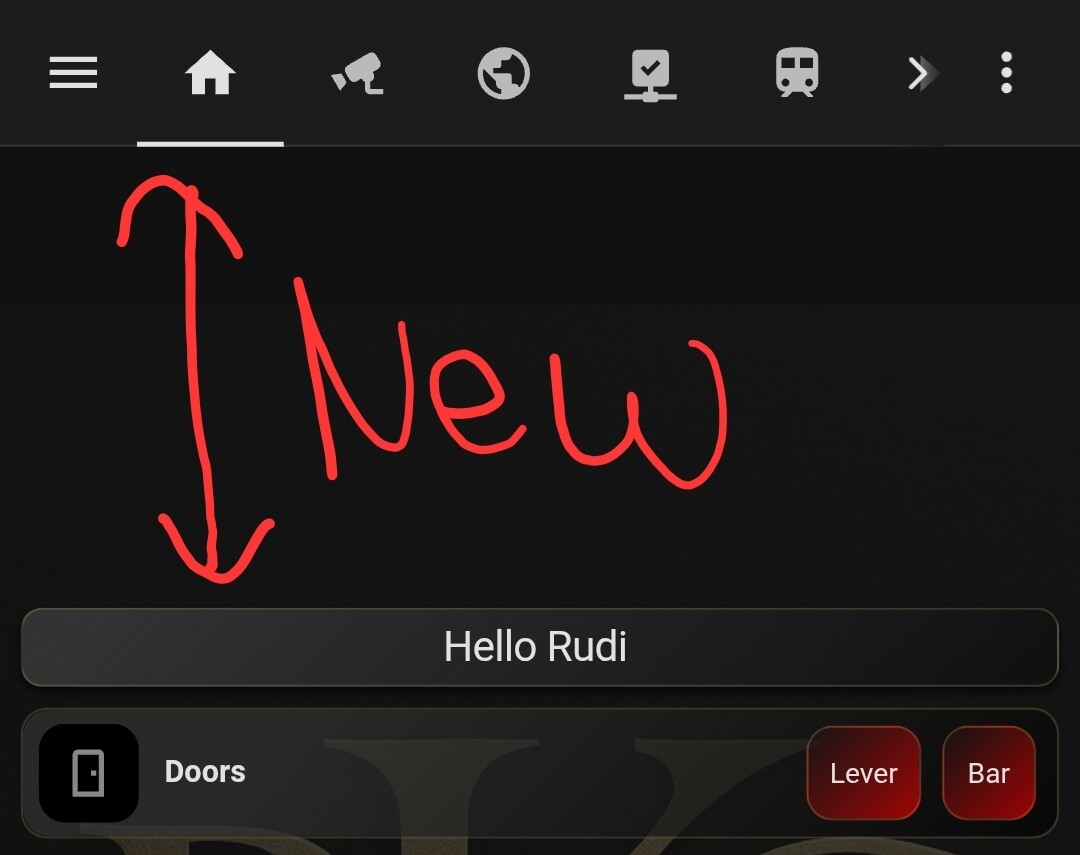

Hi there,
I’ve updated to HA 2026.4 and having compatibility issues.
The main dashboard, consisting of several popups, is showing a major empty area on the top now
The popup adjustment is broken (especially when the popup requires scrolling due to size) and scrolling is no more possible.
Any ideas?
Edit: I’ve solved the gap by re-arranging the popups (moved them behind all other cards, as described in the popup settings (when did it change from above to below other cards?)), it’s just the scrolling and adjustment of cards in popups which is no longer working.
Edit2: the fix mentioned by cloos below worked for me :+1:
Yea after updating popups are kind of messed up for me depending how many cards I have in the popup it seems, damn.
@RKCKBN @davidnestico Hi! I have a fix and I will release a new version tomorrow, I was not expecting HA 2026.4 to be released today (they usually release it a bit later), I’m sorry for that!
I’ve already posted how to (easily) fix this in the meantime here:
