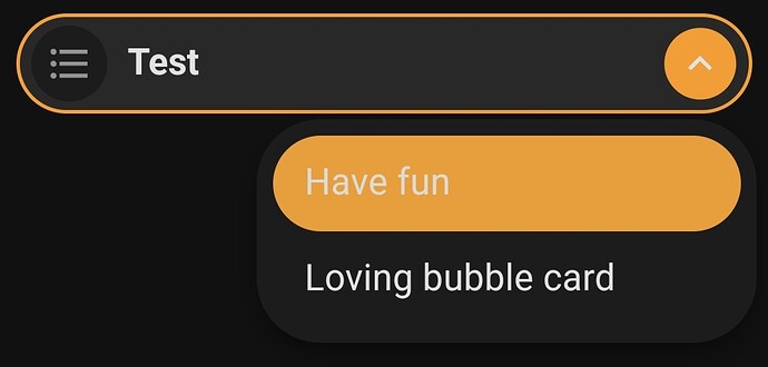

Please see the original select options that I have created in homeassistant.
Bubble Card select card is converting the strings/options to propercase. I hope I am making sense.
Please look into this and if possible kindly fix this in next update.

@Vandana Indeed this is a mistake for these select menus! I will change that in the next beta ![]()
