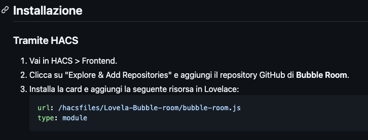

i have tried to install it with hacs but no luck
What kind of error does it give you?
When you add the repository, you need to use dashboard.
  1. Go to HACS > Frontend.
  2. Click on “Explore & Add Repositories” and add the Bubble Room GitHub repository.
https://github.com/mon3y78/Lovelace-Bubble-room”
Type: dasboard
Thank @class i have update readme
Great it is working now. Thank you :slight_smile:
