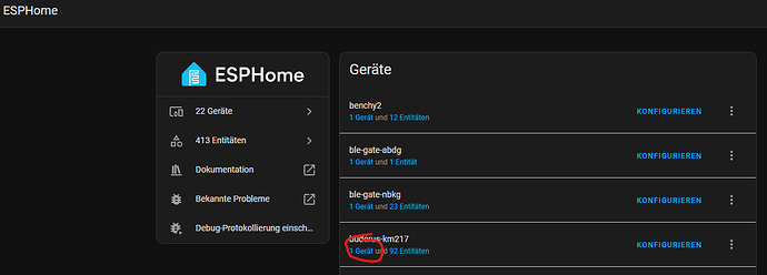

Hi Nuno,
I also noticed, that the online/offline status is sometimes a bit buggy. It sometimes shows offline, but you still can connect (show logs or update). I believe, it has to do with mDNS, depending on your network (router, switches, clients/PC…) works good, medium or bad.
To find all “exported” sensors, you should go to Settings → Devices → ESPhome → “KM271” Device.
From there, you should see all entities with their default control.
Month ago, I also had problems with ESPhome entities not showing up, but this seems to have solved long time ago… Every sensor/number/… you add in your YAML should get into the firmware and show up in Home Assistant.
Hope this helps a bit…
Regards,
Daniel
