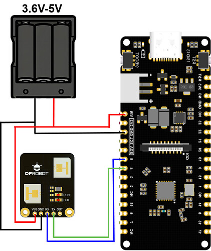

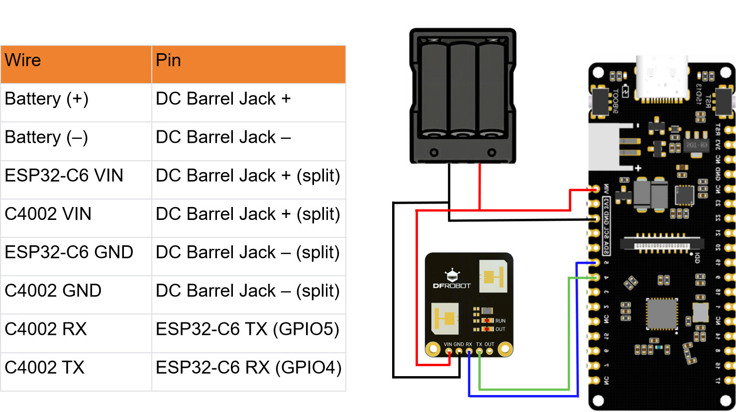

2.3 Wiring Diagram and Power Requirements

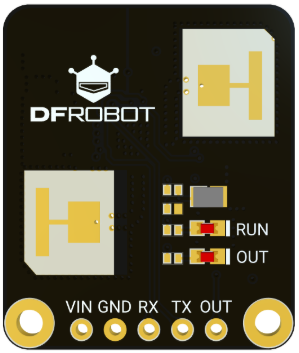

Before connecting the ESP32 and the C4002 module, it is important to understand the power requirements.
According to the C4002 documentation, the operating voltage range of the module is 3.6V to 5.5V.
  • If the ESP32 development board provides a regulated 5V output pin (for example, ESP32-S2-DevKitM-1), the C4002 module can be powered directly from the board.
  • The FireBeetle 2 ESP32-C6 does not provide a dedicated 5V output pin suitable for powering external modules. Therefore, an external 5V power source is required.
ESP32-C6 and C4002 Power Supply Notes:
In this setup, the ESP32-C6 and the C4002 module must share the same external power source and a common ground. The external supply should provide a voltage around 5V, staying within the safe operating range of both devices.
When using battery power or other unregulated sources, ensure that the input voltage does not exceed the maximum rated voltage of either device, and be aware that low input voltage may cause unstable operation of the ESP32.

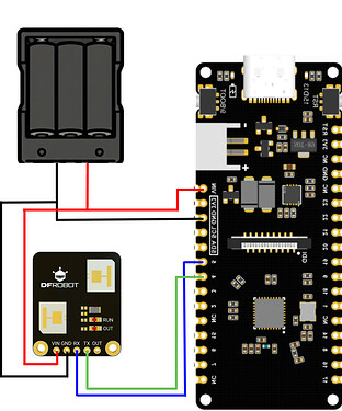

2.4 Power Distribution and Wiring

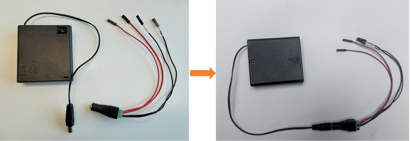

In this tutorial, power is supplied using a 3×AA battery holder with a DC 2.1mm plug and a DC barrel jack adapter (female, screw terminal type).
This allows the battery power to be easily split and connected to both the ESP32-C6 and the C4002 mmWave module.

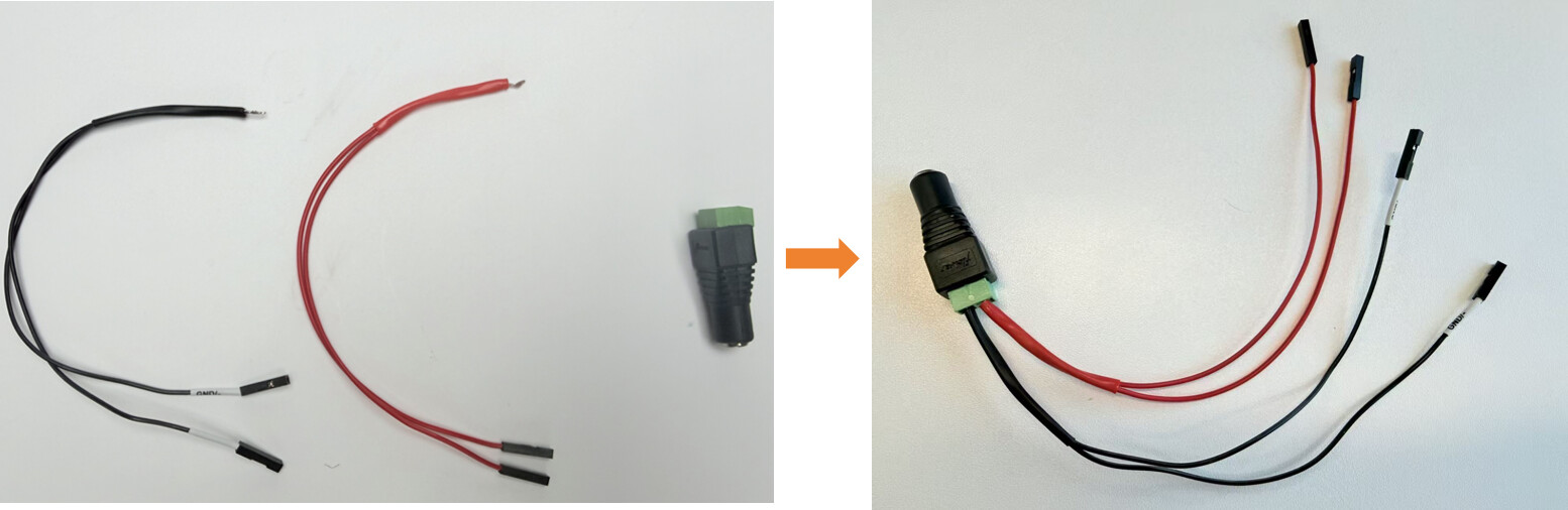

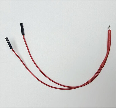

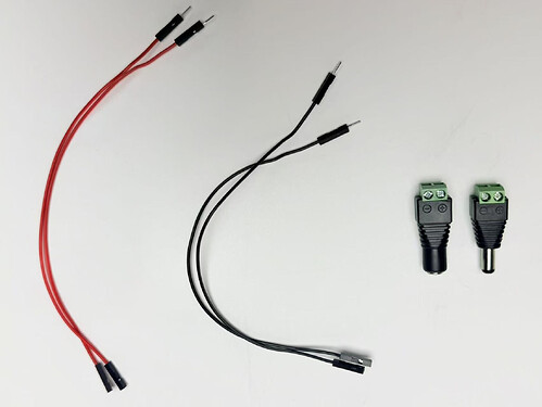

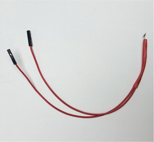

First, prepare two jumper wires to split the positive power line.Then, prepare another two jumper wires to split the negative (ground) power line.
Take two jumper wires.Strip a small section of insulation from one end of each wire.Twist the exposed copper wires together and solder them into a single joint, keeping both female headers intact.This creates one power line with two female outputs.
Repeat the same steps with another two jumper wires to create the ground line.
After preparing the two positive wires and the two ground wires, twist the ends of the positive wires together and insert them into the + terminal of the DC barrel jack. Tighten the screw securely to make sure the wires are firmly fixed and will not come loose.
Then, twist the ends of the ground wires together and insert them into the – terminal of the DC barrel jack, tightening the screw to secure the connection. Make sure that the positive and ground wires are separated and that no bare copper is exposed that could cause a short circuit.

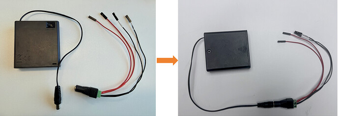

Once both positive and ground wires are properly secured in the DC barrel jack, take the assembled DC barrel jack and plug it into the DC input of the battery holder.
Make sure the plug is fully inserted so that the connection is stable and will reliably supply power from the 3×AA batteries to your circuit. At this stage, your battery power is ready to be distributed to the ESP32-C6 and the C4002 module through the DC barrel jack.
Now, use the two female jumper outputs on the positive wire to connect the VIN input of the ESP32-C6 and the VIN input of the C4002 module. Similarly, use the two female jumper outputs on the ground wire to connect the GND pin of the ESP32-C6 and the GND input of the C4002 module.
Take two female-to-female jumper wires. Connect the RX pin of the C4002 module to the TX pin (GPIO5) of the ESP32-C6. Then connect the TX pin of the C4002 module to the RX pin (GPIO4) of the ESP32-C6.

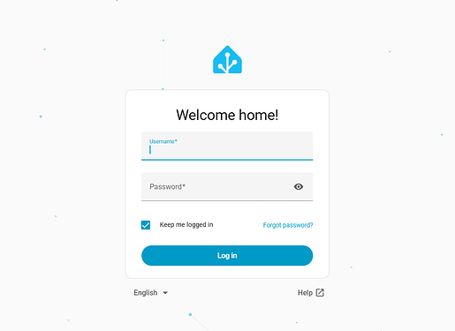

Once installed, create an account and follow through the initial set up instuctions.

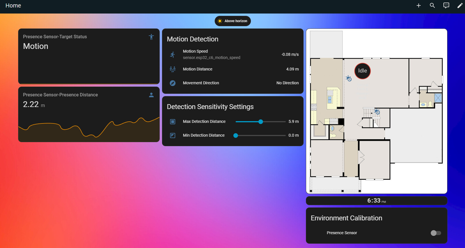

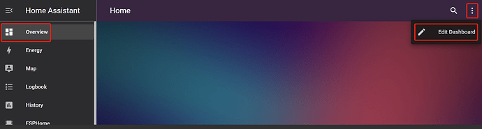

Once configured, you will see the main dashboard of Home Assistant as shown below.

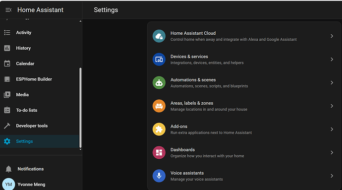

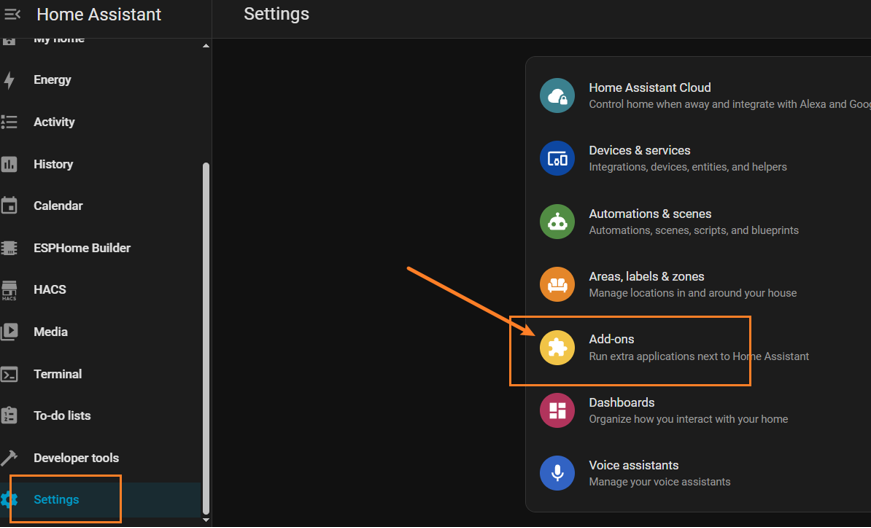

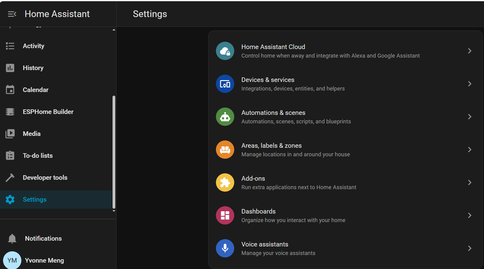

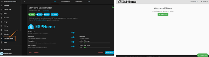

Go to the Home Assistant main page and click Settings in the left sidebar; find and click Add-ons.

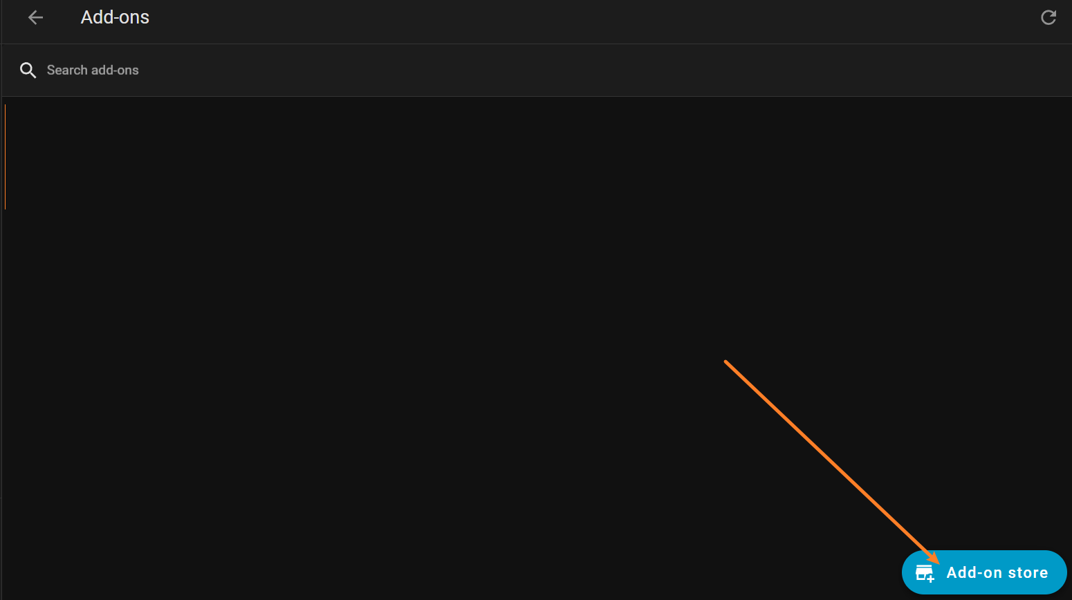

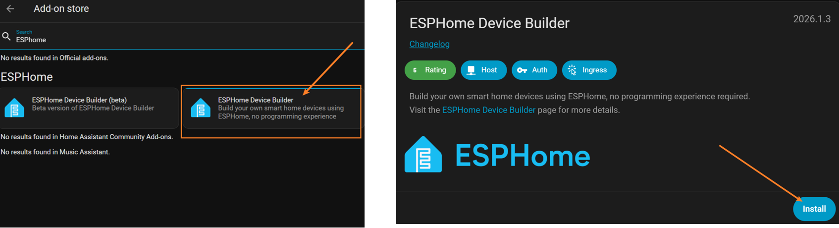

After entering the Add-ons page, click Add-on store in the bottom right corner;
Enter ESPHome in the store’s search bar and search; Select 'Esphome Device Builder ', then click Install;

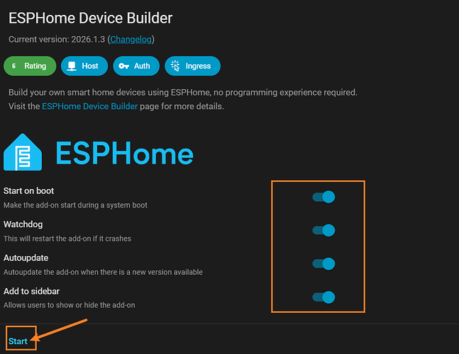

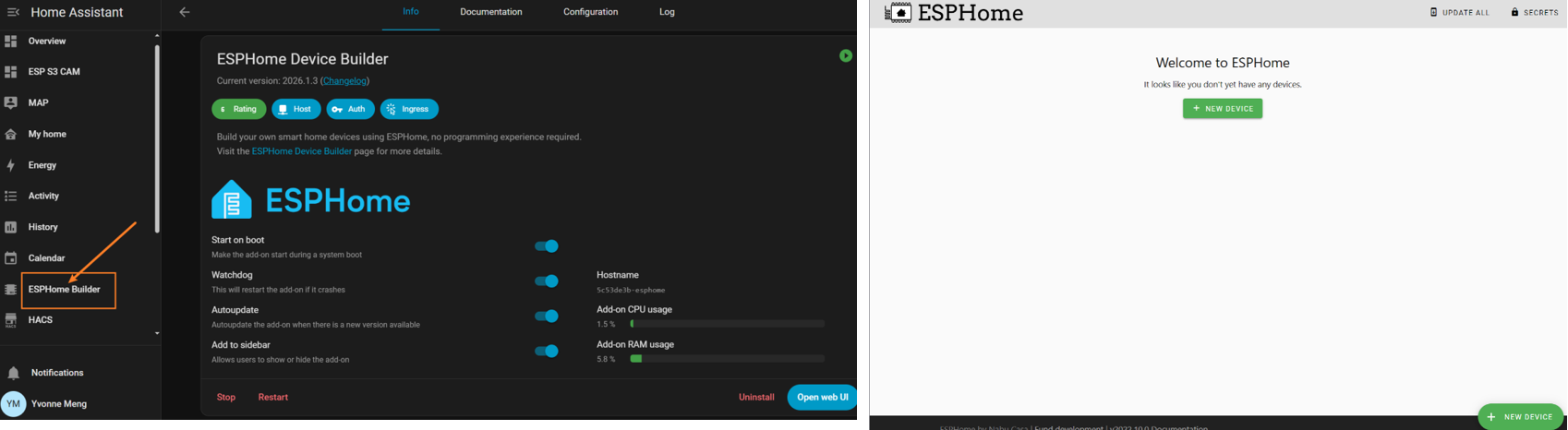

After the add-on is installed successfully, go to its configuration page, enable all functional options, and then click Start;
Wait for the add-on to start completely. If the ESPHome Builder option appears in the left sidebar, and you can enter the corresponding management page by clicking it, it means the ESPHome add-on has been installed and started successfully.

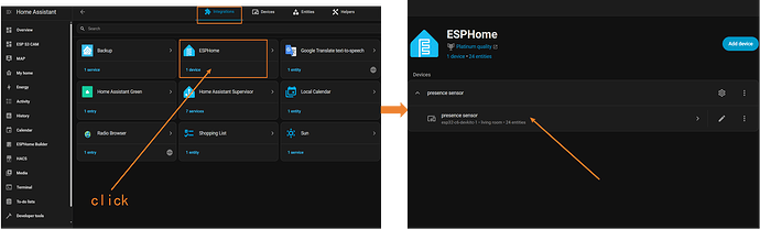

3.3 Adding the ESP32-C6 Device to ESPHome

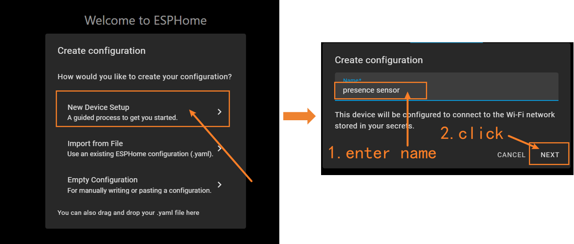

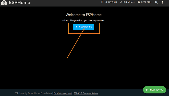

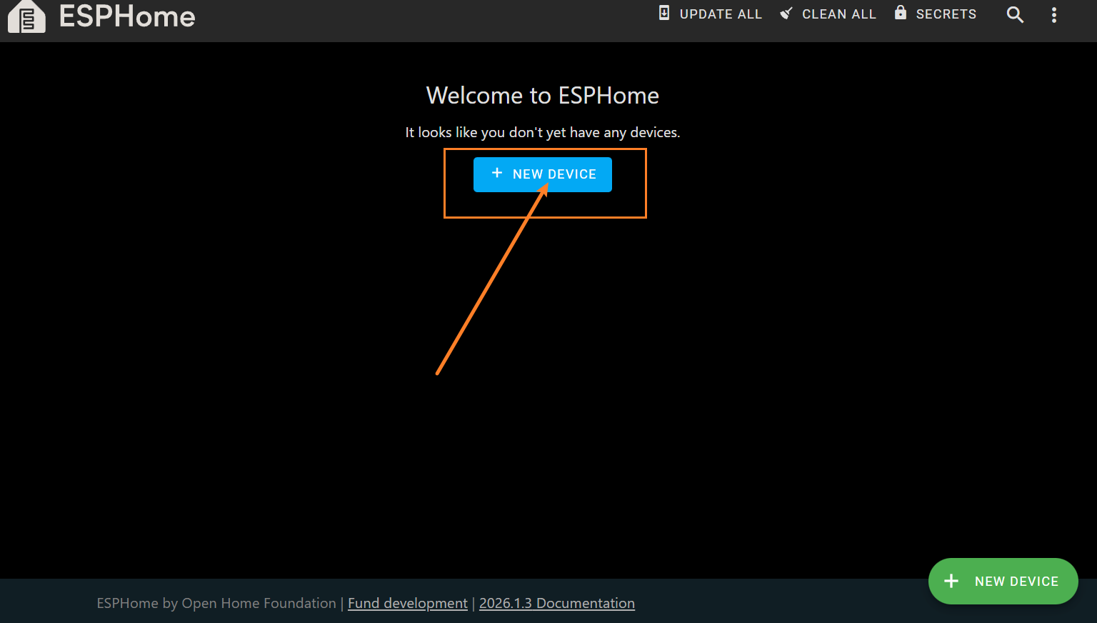

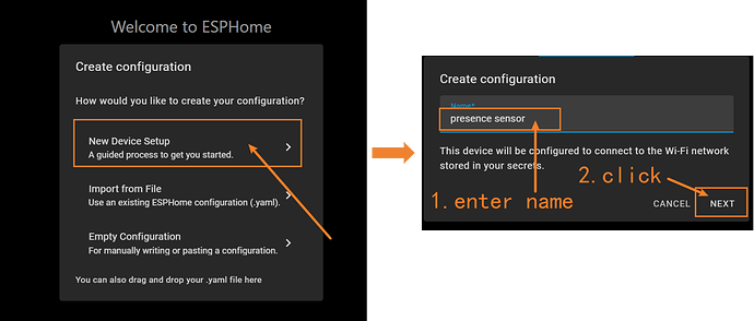

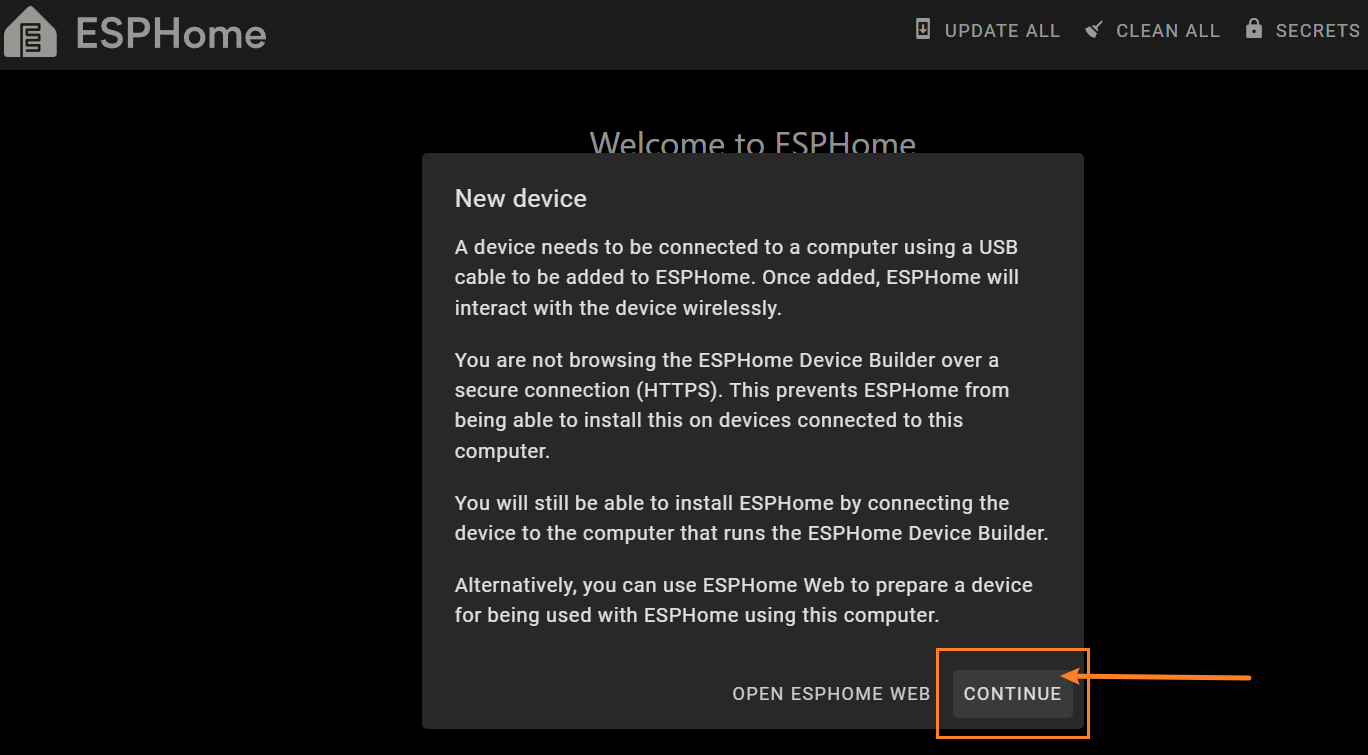

STEP 1: On the ESPHome management page, click + NEW DEVICE.
STEP 2: On the device creation guide page, click CONTINUE directly.

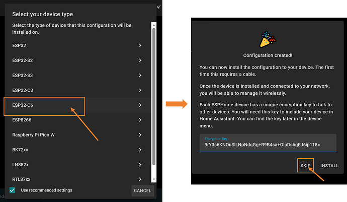

STEP 3: Enter a custom device name (e.g., presence sensor), then click NEXT.

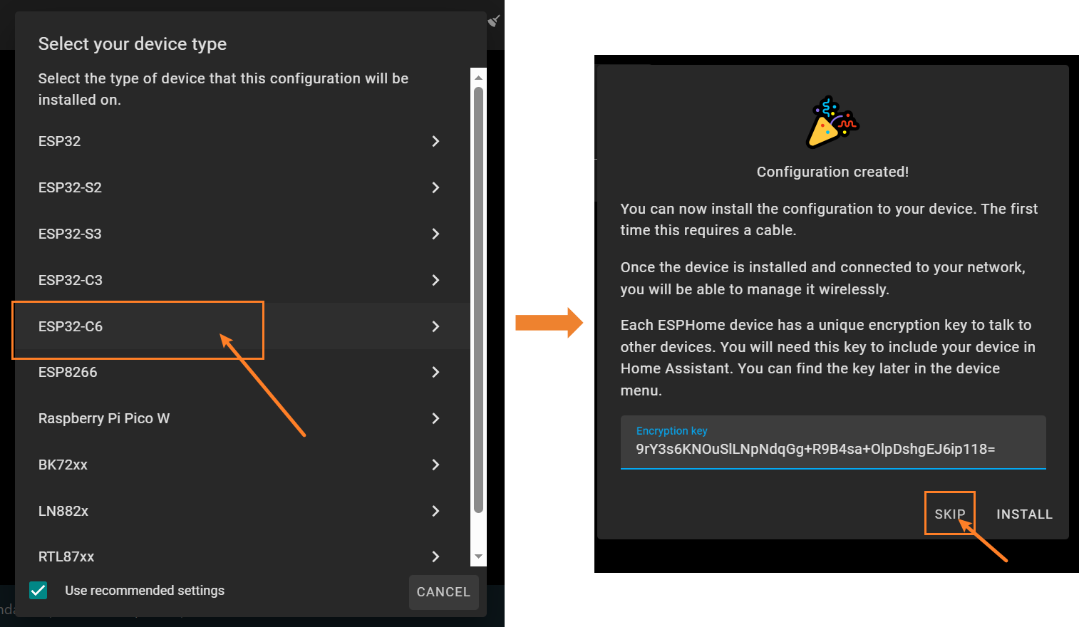

STEP 4: On the hardware model selection page, select the corresponding type ESP32-C6 for the FireBeetle 2 ESP32-C6 in use.
The page displays Configuration created, click ‘SKIP’ — because we will manually write the complete hardware and sensor configuration.

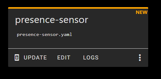

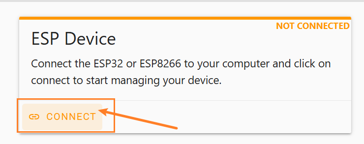

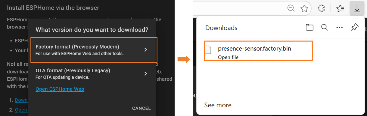

After the device is created successfully, go to the ESPHome device management list page, find the newly created presence-sensor device.

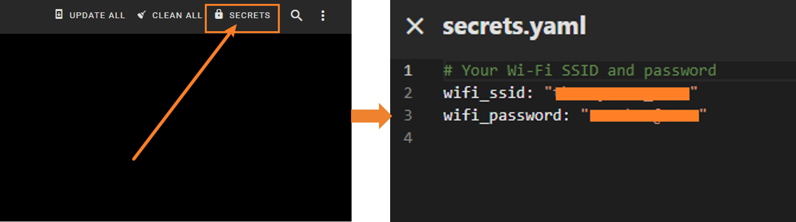

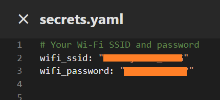

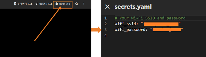

Click the ‘SECRETS’ button in the top right corner, and enter the Wi-Fi name and password.

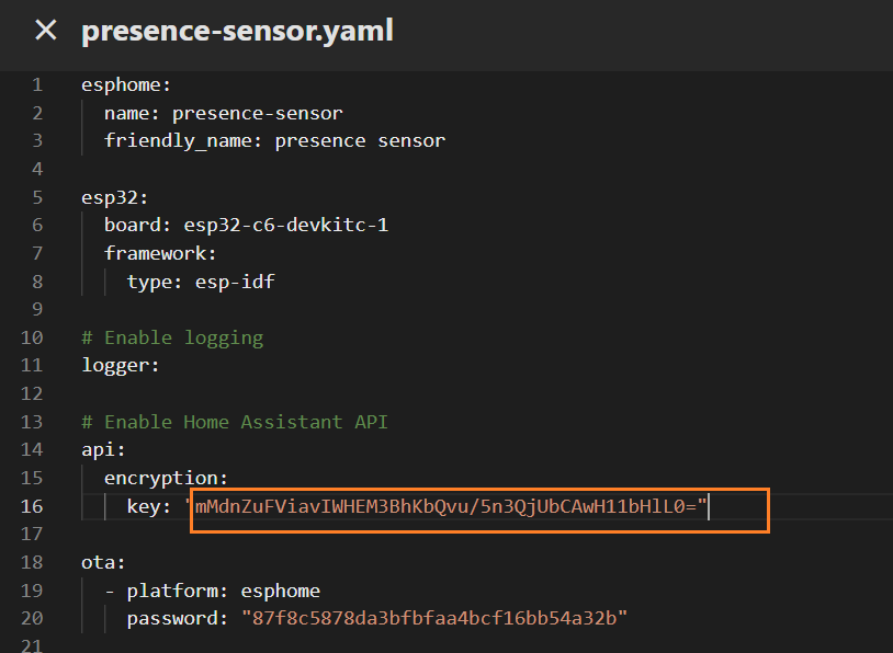

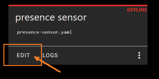

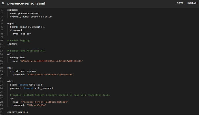

STEP 1:Click 'EDIT — this will open the YAML configuration file of the device, where all subsequent hardware and sensor configurations will be completed;
The full page after opening is shown below.
STEP2: Paste the configuration code for FireBeetle 2 ESP32-C6 and C4002 sensor to the end of the YAML file.

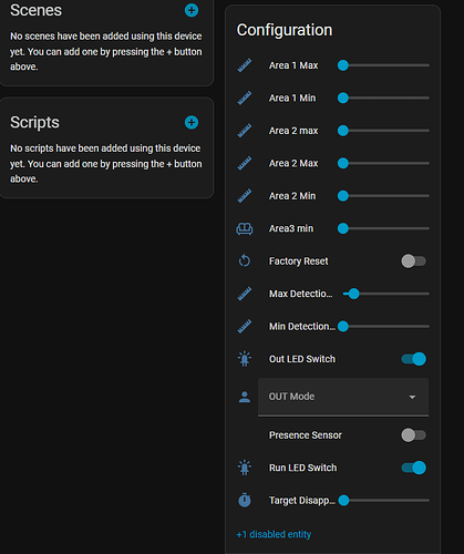

# Number Configuration Section
number:
  - platform: dfrobot_c4002
    c4002_id: my_c4002
    max_range:
      name: "Max Detection Distance"
      unit_of_measurement: "m"
      icon: "mdi:ruler"
      entity_category: "config"
    min_range:
      name: "Min Detection Distance"
      icon: "mdi:ruler"
    light_threshold:
      name: "Light Threshold"
      unit_of_measurement: "lx"
      icon: "mdi:lightbulb"
    area1_min:
      name: "Area 1 Min"
      icon: "mdi:ruler"
    area1_max:
      name: "Area 1 Max"
      icon: "mdi:ruler"
    area2_min:
      name: "Area 2 Min"
      icon: "mdi:ruler"
    area2_max:
      name: "Area 2 Max"
      icon: "mdi:ruler"
    area3_min:
      name: "Area 3 Min"
      icon: "mdi:ruler"
    area3_max:
      name: "Area 3 Max"
      icon: "mdi:ruler"
    target_disappeard_delay_time:
      name: "Target Disappear Delay"
      unit_of_measurement: "s"
      icon: "mdi:timer"
The complete YAML content is as follows.
esphome:
  friendly_name: presence sensor
esp32:
  board: esp32-c6-devkitc-1
  framework:
    type: esp-idf
# Enable logging
logger:
# Enable Home Assistant API
api:
  encryption:
    key: "mMdnZuFViavIWHEM3BhKbQvu/5n3QjUbCAwH11bHlL0="
ota:
  - platform: esphome
    password: "87f8c5878da3bfbfaa4bcf16bb54a32b"

      icon: "mdi:speedometer"
      device_class: "speed"
      state_class: "measurement"
    movement_direction:
      name: "Motion Direction"
      icon: "mdi:compass"
      # internal: true  # Comment out temporarily for data testing
    target_status:
      icon: "mdi:target"
  # WiFi Signal Sensor
  - platform: wifi_signal
    name: "WiFi Signal Strength"
    update_interval: 30s
    unit_of_measurement: "dBm"
    accuracy_decimals: 0
    device_class: "signal_strength"
    entity_category: "diagnostic"
text_sensor:
  - platform: template
    name: "Movement Direction Text"
    icon: "mdi:directions"
    lambda: |-
      if (id(movement_direction_sensor).has_state()) {
        int d = id(movement_direction_sensor).state;
        if (d == 0) return {"Approaching"};
        else if (d == 1) return {"No Direction"};
        else if (d == 2) return {"Away"};
        else return {"Unknown"};
      return {"No Data"};
    update_interval: 1s
    name: "Target Status Text"
    icon: "mdi:human-greeting"
    lambda: |-
      if (id(target_status_sensor).has_state()) {
        int d = id(target_status_sensor).state;
        if (d == 0) return {"No Target"};
        else if (d == 1) return {"Static Presence"};
        else if (d == 2) return {"Motion"};
      return {"No Data"};
    update_interval: 1s
    c4002_id: my_c4002
    c4002_text_sensor:
      icon: "mdi:message-text-outline"
# Switch Configuration Section
switch:
    c4002_id: my_c4002
    switch_out_led:
      name: "Out LED Switch"
      icon: "mdi:led-on"
    switch_run_led:
      name: "Run LED Switch"
      icon: "mdi:led-on"
    switch_factory_reset:
      icon: "mdi:restart"
    switch_environmental_calibration:
      name: "Sensor Calibration"
      icon: "mdi:calibration"
# Select Configuration Section - Fixed operating_mode
select:
    c4002_id: my_c4002
    operating_mode:
      icon: "mdi:account"
      options:
        - "Mode_1"
        - "Mode_2"
        - "Mode_3"
number:
    c4002_id: my_c4002
    max_range:
      icon: "mdi:ruler"
    min_range:
      icon: "mdi:ruler"
    light_threshold:
    area1_min:
      name: "Area 1 Min"
      icon: "mdi:ruler"
    area1_max:
      name: "Area 1 Max"
      icon: "mdi:ruler"
    area2_min:
      name: "Area 2 Min"
      icon: "mdi:ruler"
    area2_max:
      name: "Area 2 Max"
      icon: "mdi:ruler"
    area3_min:
      name: "Area 3 Min"
      icon: "mdi:ruler"
    area3_max:
      name: "Area 3 Max"
      icon: "mdi:ruler"
      icon: "mdi:timer"
STEP 3: Click SAVE in the upper right corner of the page to save the configuration.
2e174a29036b43c6a6624b216cc34e41

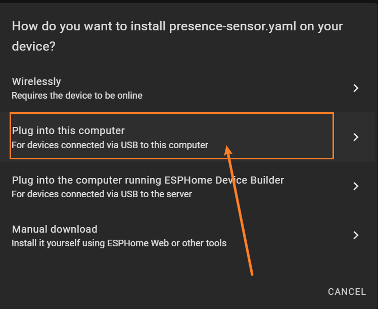

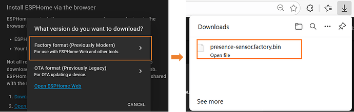

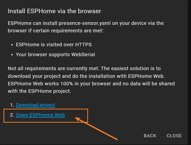

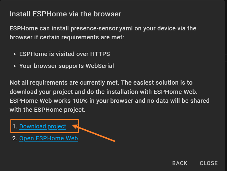

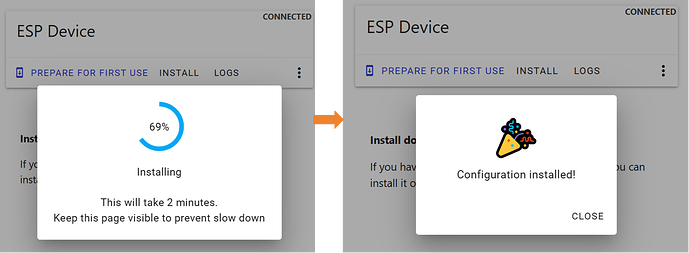

STEP 4: Click INSTALL to trigger firmware compilation;
A pop-up window for installation method selection appears, select ‘Plug into this computer’, then click ‘Download project’ to start firmware compilation.
Compilation Completion Mark: The Download project button changes from gray to clickable (firmware compilation takes about 10-20 minutes, please wait and do not close the page);

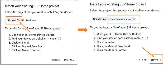

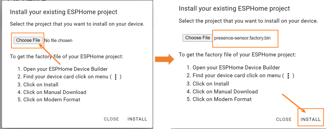

After the firmware is compiled, click ‘Download project’, select the ‘Factory format’ mode in the flashing options, and download the firmware file (the file name is presence-sensor.factory.bin);

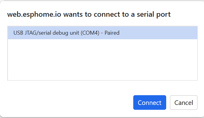

STEP 5: After the firmware is downloaded, click ‘Open ESPHome Web’.

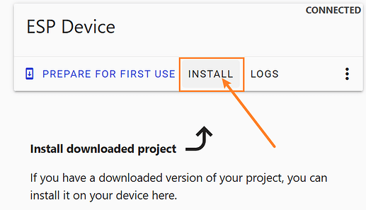

Ensure the FireBeetle 2 ESP32-C6 is connected to the computer via a USB cable.
Then click ’ CONNECT 'on the flashing tool page.
In the pop-up serial port selection box, select the serial port corresponding to the FireBeetle 2 ESP32-C6, and click Connect to complete the device connection.

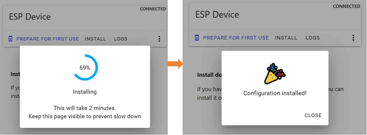

STEP 6: After the ESP32-C6 is successfully connected to the flashing tool, click INSTALL on the page.
Click ‘Choose File’, select the newly downloaded presence-sensor.factory.bin firmware file, and click INSTALL to start flashing.
Wait for the firmware flashing to complete,the page displays a flashing success.

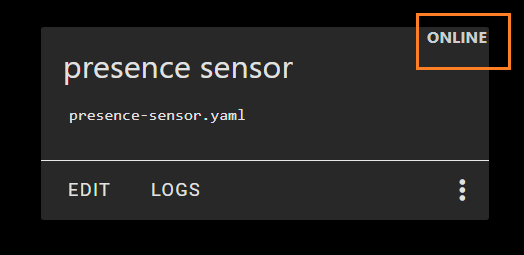

STEP 7: Unplug the USB cable to disconnect the ESP32-C6 from the computer. Connect the battery pack, ESP32-C6, and C4002 motion and presence module according to the following wiring diagram.
Return to the Home Assistant page and you will see the presence sensor device go online.
If it shows offline, the board is most likely failing to connect to the WiFi. Please check if the WiFi SSID and password in the secrets.yaml file are correct.

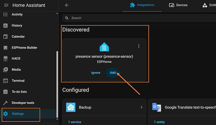

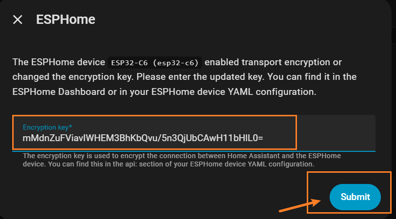

STEP 8: After the presence sensor device is online, click Settings – a notification for new device discovery will pop up on the page, then click Add.
Locate the corresponding API key in the presence-sensor.yaml file.
Fill it in the designated input box of the pop-up.
Once completed, click ‘Settings’ and navigate to the ‘Device & Services’ page.
Click ESPHome and check that presence sensor appears on the page.

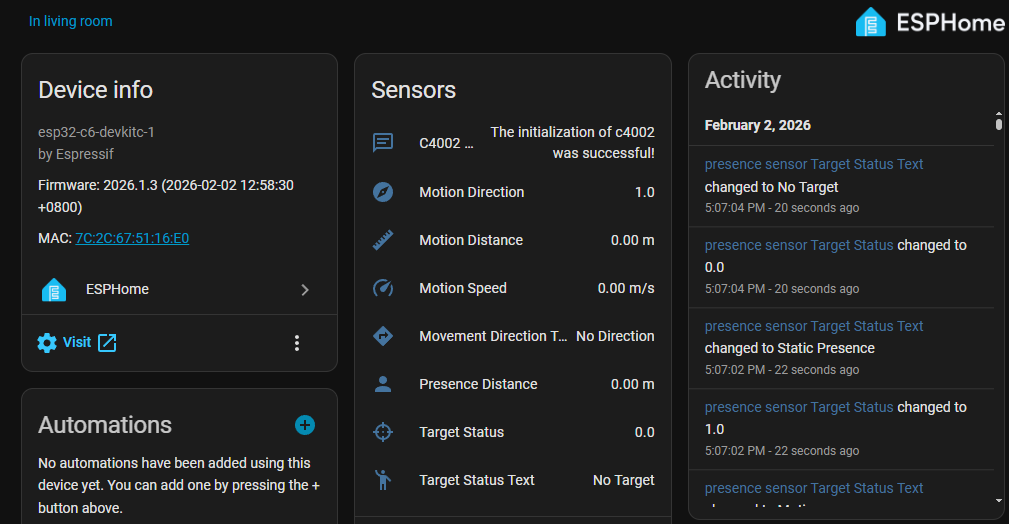

Click ‘presence sensor’ and you will see the following device information:
Sensor Data Items
  • Motion Distance: Real-time distance between the target and the sensor when a moving object is detected
  • Presence Distance: Real-time distance between the target and the sensor when a static human body is detected
  • Motion Speed: Moving speed of the detected target
  • Motion Direction (numeric): 0=Approaching, 1=No direction, 2=Moving away
  • Target Status (numeric): 0=No target, 1=Static presence, 2=Motion detected
In addition to the sensor data, the following configurable options are available:
  • Sensor OUT Indicator Light Switch: Controls the on/off state of the sensor’s physical OUT LED
  • Sensor RUN Indicator Light Switch: Controls the on/off state of the sensor’s physical RUN LED
  • Restore Factory Settings: Momentary trigger switch that auto-resets after activation and restores the sensor to factory default parameters
  • Environmental Calibration: Momentary trigger switch that auto-resets after activation and calibrates the sensor to the current environment for improved detection accuracy
  • Detection Distance Setting: Customize the sensor’s effective detection range
  • Light Sensing Threshold Setting: Configure the trigger threshold for the sensor’s light-sensing detection
  • Detection Exclusion Zone Setting: Customize up to 3 detection exclusion zones to avoid false detections caused by objects such as furniture

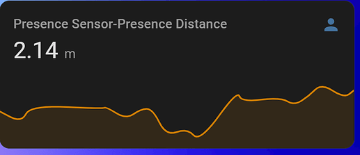

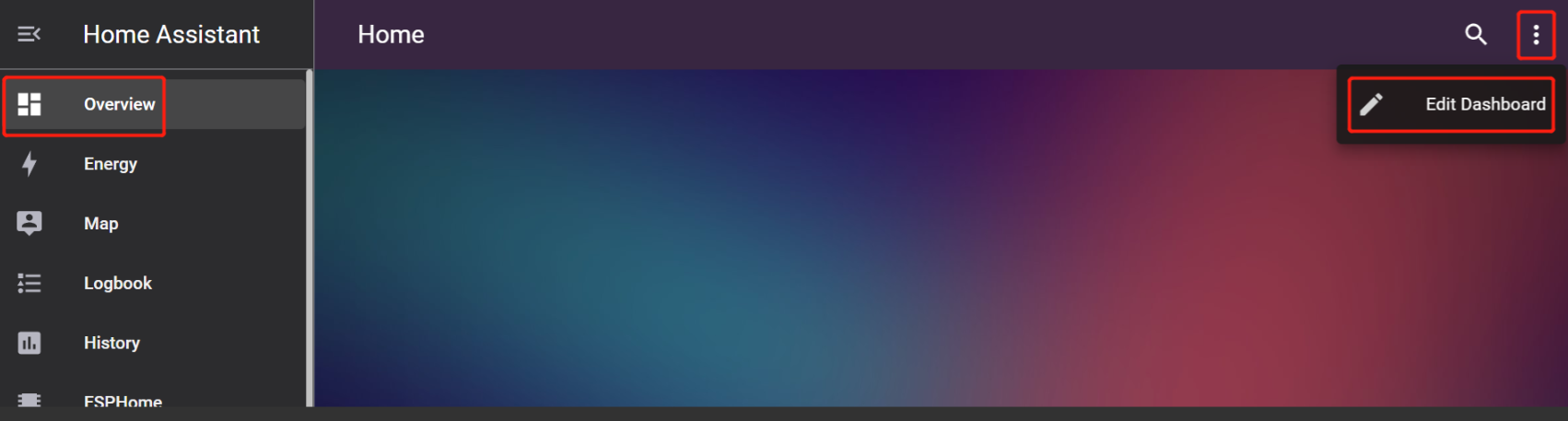

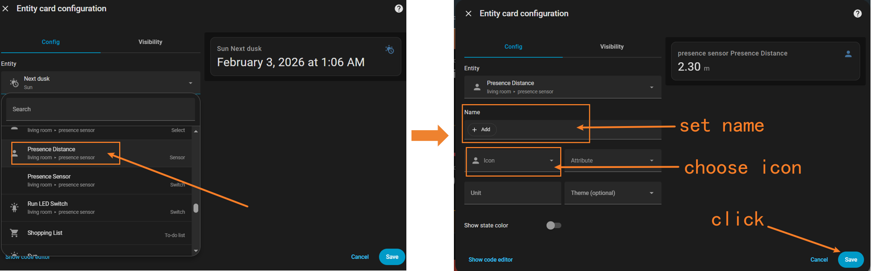

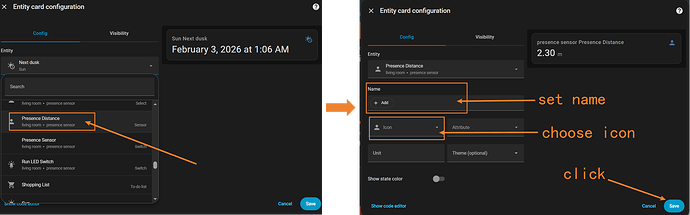

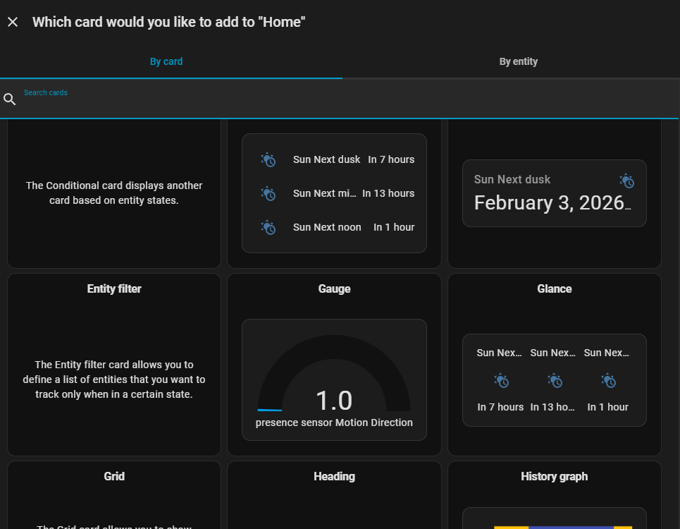

3.5 Visualizing mmWave Presence Data in the Home Assistant Dashboard

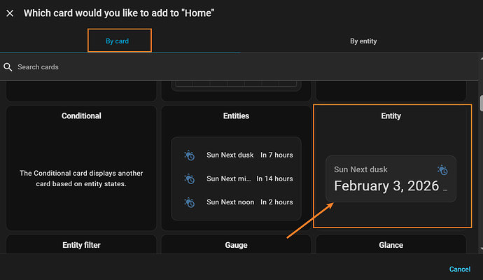

On the Overview page of Home Assistant, click the three-dot icon in the top right corner and select Edit Dashboard.
Then click ‘+ ADD CARD’.
If you want to display the C4002 sensor data via a card, select the the ‘Entity card’, then choose the relevant C4002 entities (e.g., Presence Distance).
You can customize the card name and icon, then click ‘Save’. A dedicated data card will be created, allowing you to view the real-time human presence distance data detected by the C4002 Motion and Presence Detection Module.
Click ‘Save’. You will see an entity card appear on the dashboard, displaying real-time human presence distance data detected by the C4002 Motion and Presence Detection Module.
In addition, you can select different card types to create various data visualization effects.
In addition, you can select different card types to create various data visualization effects. This is my practical project of a human presence sensor, which can detect human presence and motion status in the living room.
Now it’s your turn to make your own!

Great detailed tutorial, but I highly suspect your device won’t last very long on battery without power management.
Spot on. To be honest, for long-term setups, I’d suggest just plugging it into a 5V DC adapter instead of using batteries. It’s way more stable for something like mmWave that needs constant power.
